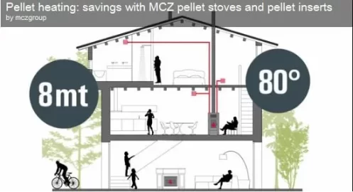

MCzed video
Interesting, We now have a number for ducted air temperature for a wood pellet stove!!
Vid shows duct work temperature of 80 Degrees C or 176 Degrees F , So the 150 Degrees F I measured in our duct work is completely reasonable!!!
Looks good!
http://www.youtube.com/watch?feature=player_embedded&v=uzR4BOqTZZk
Also looks like a max of 8 meters which is 26.25 feet, our ducting is alot less too !!!
Website
(broken link removed to http://www.woodpelletstoves.ie/mcz-heating-collection)
See pic 1 of Forced Hot Air wood pellet stove

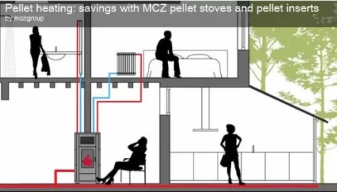

and See pic 2 of Hydronic wood pellet stove below:

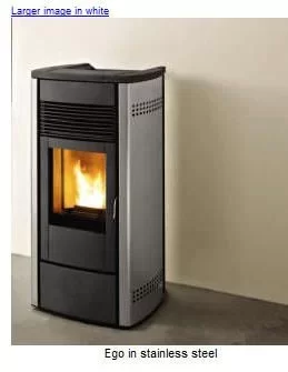

i actually just purchased a mcz pellet stove (wittus EGO but its not ductable)
Hi CrowBean
How do you like the EGO?? How large is the Hopper??
http://www.wittus.com/DProducts/wpdopellet.htm
The Ego and Star's innovative Active System instantly adjusts the combustion air to compensate for minor variations in pellet size and density. The stove determines the perfect amount of air to obtain the best possible combustion in any installation configuration.
The top mounted user-friendly LCD display control panel monitors the internal functions and provides valuable information to keep your stove running at peak performance. No doubt about it, this is a smart system!
Other features include:
pre-programmed user selections
optional remote control
self-cleaning burner box
easily removable ash drawer
large hopper capacity
gentle flame patterns for enjoyable viewing
quiet operation to give you a stove that is a joy to own and operate.

The EGO is being installed in 3 weeks after i build the hearth out of stone. I will definitely update you now that i am addicted to this forum and pellets! The ductable units are very nice but i end up getting the ego, install, tax, ash vac, 2 cleanings for 4000. The ductable units start at 4500. Alittle too out of my price range after install and other goodies but a great design. I am very excited about the features and the possible 90 percent efficiency.
Sounds like a very nice unit! Does it use US standard 3" pellet flue pipe?

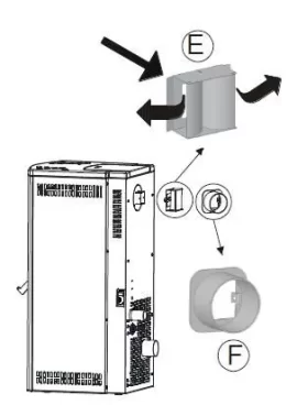

From Manual
CONNECTIONS OF HOT AIR DUCTS FOR
SUITE/CLUB/MUSA COMFORT AIR MODEL
Once the stove is in position, you can begin installation of the hot air
ducts.
Comfort Air stoves are provided with an air deflector E as standard. This
means that the rear flange for hot air outlet is connected to this
deflector, which allows the hot air to be directed to the right and left of
the room, in case the channelling of hot air is not desired.
If you wish to channel the hot air, the deflector E must be removed.
Connect the soundproofed connection F (optional) that makes the
output from square to round 3â€, and then make the various connections
through the wall using only “type B†vents. To transport hot air inside a
wall use the proper “type B†oval ducts suitable to be walled in (see
connecting examples in the figures on the right)
The air outlet heating air can reach very high
temperatures, up to 180°C: it is therefore necessary
to use “type B†vents where it may come into contact
with flammable surfaces or that are affected by the
temperature (e.g. discolouration of paint, ducts for
electric cables, plasterboard, etc.); it is also
necessary to protect people and animals from
voluntary or accidental contact. In any case comply
with the regulations and laws in force in the region
where the product is installed.
It is advisable to provide insulation along the entire
route of the pipe to decrease dispersion and increase
the heat energy in the environment.
A pipe which is inserted in the wall must be properly insulated so that it
does not lose heat and so that air outlet is silent.
8 meters is the maximum suggested length for
ducting hot air in other ambients.
