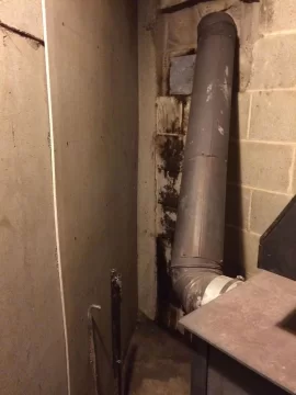

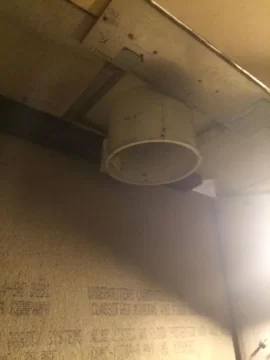

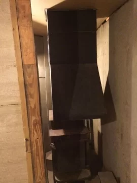

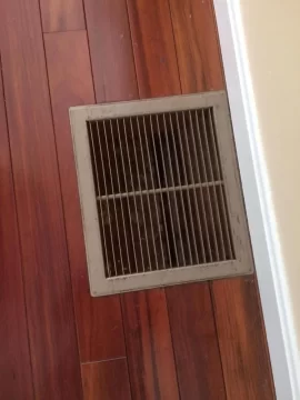

Update: Home inspection went very well. Here are the pics, as promised.

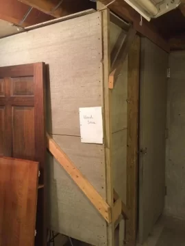

Here's the little "stove room" I mentioned in the basement.

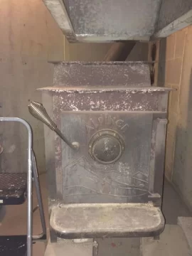

A look at the outside of the wood stove.

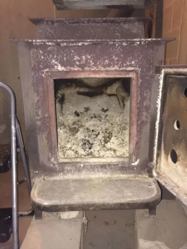

Inside the stove.

Here's the primary duct/vent. It leads to two vents on the main floor.
[Hearth.com] New to This: Buying a house with a ducted wood stove. Process to convert to pellet stove?
This is also in the "stove room" on the ceiling. It leads to the upstairs vents (second floor).
Here's a look at the chimney/flue (is that the right term?) coming from the stove.

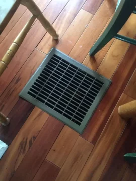

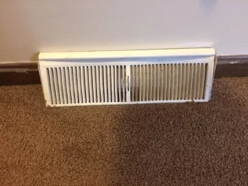

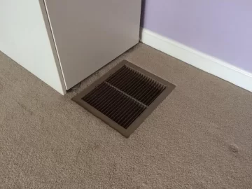

Below are pics of the actual vents in the floor. The first two are on the main floor, and the second two are on the second floor (one hallway, one bedroom).
Some questions:
  • Would it make sense to swap this wood stove for a pellet stove? Does the space allow for it?
  • Any concerns about the set-up? The walls in the "stove room" are Durock, if that makes any difference.

That is so old school and not safe. Seriously not safe. JMO.
That was my first impression ... can`t imagine it is a legal install. What did the inspector have to say about it?
Wow ... I'm no where near knowledgeable enough to give advice on install of a wood stove but I know enough that I wouldn't be happy with that set-up. What are the inspector's credentials?
