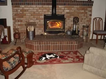

We love our Liberty. It's our primary source of heat in a ~2600 square foot two-story house (upstairs partially lofted/open to the great room where the stove is). We have an electric forced air central furnace, but hardly ever turn it on unless we're going to be away from the house for a while in very cold weather. Here in the central Oregon high desert country, our only available sources of fuel for woodstoves are softwoods...Pine, Juniper, Fir , Larch (Tamarack), like that. They tend to burn quickly and hot. Achieving what the easterners with their wonderful hardwoods refer to as an overnight burn is a real challenge, even with the Liberty's big firebox. I have another stove with a smaller firebox that I use every day as well, so almost all my wood is about 16" splits/rounds, even though the Liberty could swallow a 24 incher. I can't say I've ever really "stuffed" it full of wood, but I have gotten it pretty darn full atop a really nice bed of coals, waited for it to engage nicely, then damped down the primary to nearly shut (not all the way shut). This will extend the burn for a number of hours, and there will be some coals left in the morning, in a stove that's warm to the touch and not difficult to start back up. I'm quite sure that with a different fuel, this stove is more than capable of an honest overnight burn of maybe 10 hours, or so. Send me a few cords of Oak or something and I'll forward the results of my testing in February. :-P Rick
