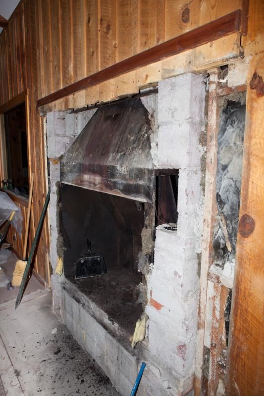

When I got all the old masonry removed, this heatform box reared it's ugly head. The local guy came by and said I could remove it If I wanted to. That didn't sound right to me ... that's the first day I found hearth.com. The more time spent here, the more comfortable I became with thinking I could do this myself. Trying to remove that box would've been nothing short of disastrous (Thank You hearth.com) so I let my "help" go and didn't look for a replacement.

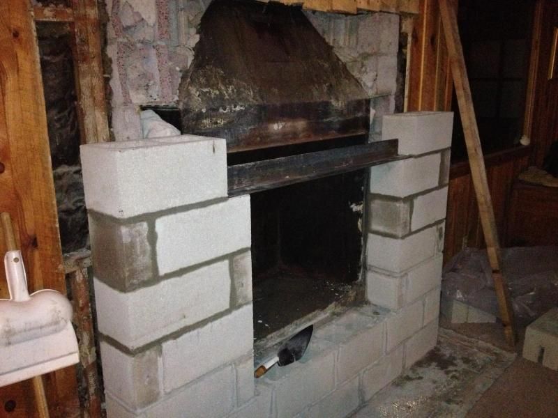

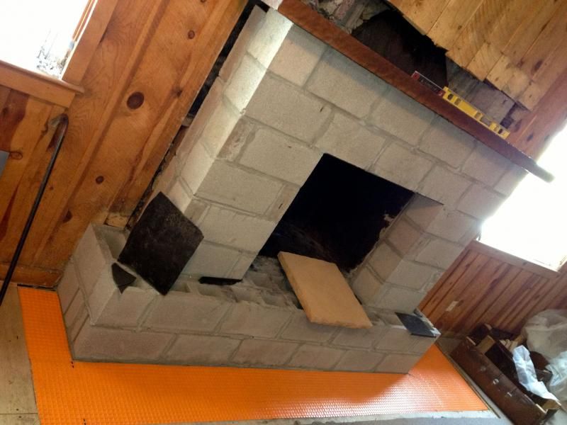

This was my first masonry attempt and it went dreadfully slow but progress was made.

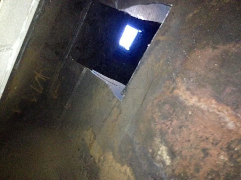

Next up was cutting a hole in the steel box for the flex liner. The chimney is big, 13 x 17 outside liner dimensions, and my hope was to get a big hole right under the flue and be able to install the liner from below rather than wave that thing above my head at the top of a ladder.
Bingo ;lol

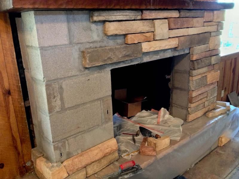

Boral cultured stone next ... Country Ledgestone. Laid out a pattern for the part of the chimney above the insert but basically went by shape and fit for the rest.
[Hearth.com] New masonry, cultured stone and Grand Voyager
According to plan :cool:

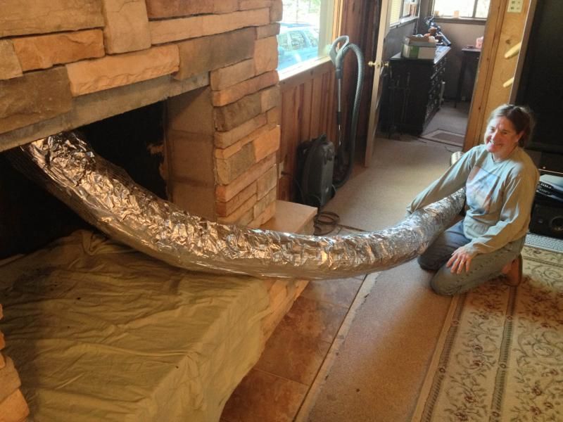

The Grand Voyager manual says the stove was designed for 6" liner, 14 to 16 feet long. Floor to top mine is 17 feet but we are at 8500 ft. Dealer said insulation was not necessary but reading here I felt different, so we wrapped the blanket.
Fire In The Hole

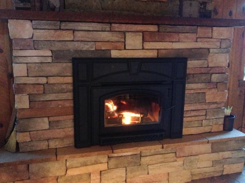

Love the Grand Voyager so far. I tried to light a tame fire last night for the first one (even though the manual doesn't say anything about break in fires). Totally botched the start up. Firebox filled with thick smoke and a nasty stain on the glass that wouldn't budge with glass cleaner or water/ash mix this am. Saw something that said a hot fire was the best next step and Hot Damn I thought that was a fine idea ... Got a hot one going now and we're very happy with how the insert burns and also with the quietness of the fan.

Very nice job.
I got scared when I opened up and saw that first picture, but man, that is one sweet job you did........congrats and enjoy....
That's a great improvement. Nice teamwork! Thanks for sharing.
That is a very nice looking fireplace. I like the three horizontal stones above the stove and the square one in the middle, nice touch.
