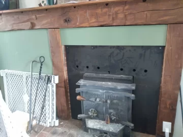

Hi all. Happy to have found this forum. We have an 1840s small brick farmhouse with an Old Timer stove in the fireplace. Want to replace with something more modern looking and efficient for the tax credit. Looks like good options include the BK Sirocco 25, the Napoleon, and a Regency Cascade Hybrid. All three very different it seems. Curious what feedback you all might have on these or others. The opening is big enough for 'medium' but not 'large' stoves. Thanks.

Tell us more about the house and the fireplace. How many sq ft are to be heated by the stove? Is the floorpan fairly open or closed off into rooms with doorways? What are the fireplace dimensions including depth? Pictures are welcome.
Floorplan is closed with doorways into other rooms. Large temp differences in the winter. Living room maybe 1000 sq ft at most. Opening is just 42" wide. Only about 30" in depth available. Local company recommended the BK.
