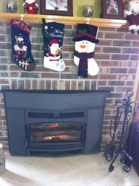

I heat 1200 sf in ct. my house is a raised ranch 2x6 construction built in 1994. I have a Lopi cape cod flush insert. Heats my house well as long as we stay in the teens after that I can kind of maintain temp in my house.

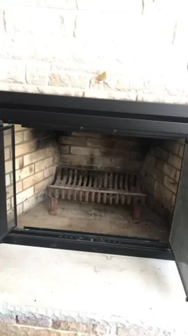

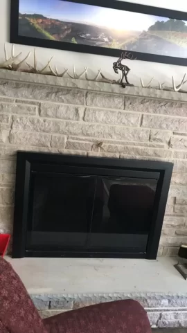

Tell us more about the fireplace and if possible post a picture or two of it. Also post the full dimensions front and back including depth top and bottom. Also, roughly how tall is the flue on this fireplace.

I'm not sure how to post pics on here but my fireplace is about 40"wide in the front, 30" deep with the flue being 35" up. The more i research, I'm looking for a non catalytic insert. Just trying to read through reviews and pick the best one. Looking like PE summit or super are pretty popular.

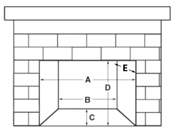

You have a lot of choices. Look at inserts in the ~2 cu ft range. The PE Super insert would do the job well. No need for a Summit based on the requirements. You could even get away with a smaller insert like the Enviro Kodiak 1200. Here are the measurements needed to check the fit. Also, how tall is the chimney on this fireplace? One story, two story?
