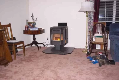

Here is a Piccy of our (new to us) Whitfield (largest stove we have)
The Stove cost $200 off craigs list and the entire setup with the raised hearth, corner Faux brick paintwork and mantle including new pipe for the stove Cost about $600 and a couple weeks to do the entire thing.
The other Piccy is the little Whitfield thats our "backup" and shoulder season stove and also may see duty when it gets COOOOOOOOOOOOLD outside. If it gets below about 25F it takes 2 stoves to heat this barn.
The little Whitfield was also found on Craigs list and again the price was $200 and it came with the hearth pad too.
The only thing I had to purchase new was the Pipe and wall thimble.
