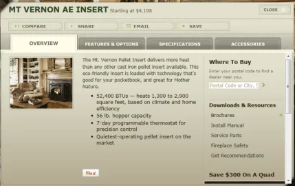

The hopper capacity for an insert is 56 lbs. You state you can only fit 20 lbs in?

Regarding the capacity of the hopper, you have to get your hand in there and tuck the pellets under an overhang on the left. The hopper will hold about 1 bag.

This is an insert, doesn't have the capacity of the free standing.
freestanders spec out at 80 lbs. :rolleyes:

My insert will hold a full bag (40lbs), but there is no way I could stuff more than that in without breaking something.
