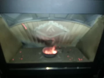

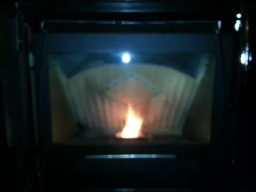

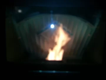

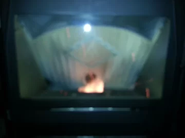

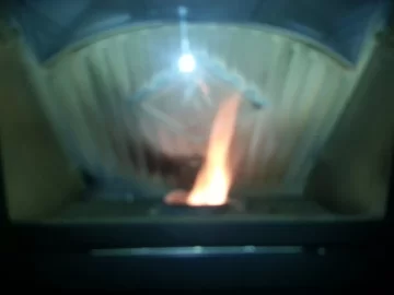

I have some photos from the last time I was there. They were taken after about an hour. The photos came out blurry but maybe it will give you some idea. I attempted to get photos of all the flame heights It runs through. I was unable to capture one where it is deep in the pot and almost going out. Most of the time the flame is around the bottom of the diamond. The flames are not lazy at all. They are very lively and you can hear the air whooshing about. This is all set to high heat, normal blower, #5 flame height. My liner is 4" and I think it ended up being about 30' long. Heat output at the center stove vent is normally around 180 degrees F with C&C pellets.

What kind of pellets are you burning? What brand? Now think about 180 degrees coming out of your stove vent with your stove on normal blower and running on high.... That blower is pushing between 700-800 cfm on high of 180 degree air.... That should mix in and fill the entire room in a matter of say like 30 minutes... If its taking longer than that you house is leaking some air somehow.... Running the stove maxed out on every setting is not a good idea and is not going to solve your issue. This unit is designed to "heat up an area once" and maintain it constantly all winter long. It only burns with a small flame and extracts a huge amount of heat off this small flame. I would do the following.....
