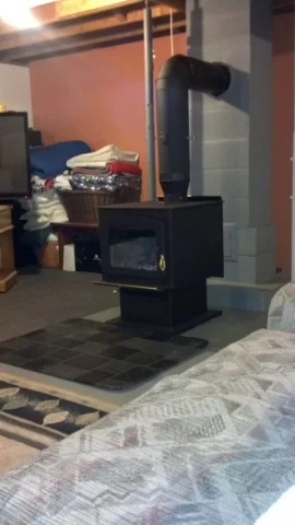

Burning kinda low, ain't it? >>
Its a warm day here in Indiana today So I havent reload yet buts its 12 hours later and I could fire it back up right now if I wanted . Its has some huge coals left in there.
One thing I forgot to point out, it has a nice large lip to catch ashes on the front of stove, larger than my other stove.
Looked like ya hadn't even fired it yet. Should have known you couldn't resist.

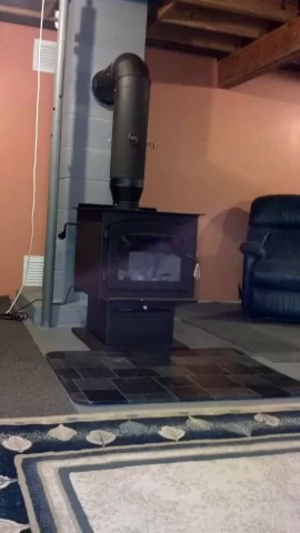

Here Ya Go.
Nice fire! It looks like a lively fellow. Is that with the air turned all the way down?
Yep, air all the way down but a couple minutes later it put the fire out. This air control totally shut seems to really cuts the air off alot.
I put some marks on the pull in and out lever so I can make judgments on where its at. I align the marks with the outer edge of the ash lip looking at it from a side view.
