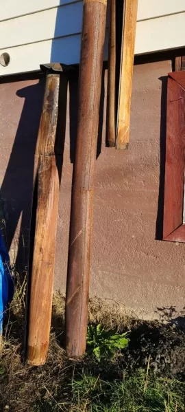

Finally got a photo of the condition of the old stove pipe that was run up the chimney. It's obviously a little smashed from me throwing off the roof, but the seems had started to separate quite badly, and some of the joints had one or two screws left holding everything together...
I can't believe this is how these used it for years.
There's a photo of the new setup too, there's a fully stuffed and shut down load in the stove and virtually zero smoke. I'm super happy. Upstairs was 72 degrees all night last night with 24 degree outdoor temperatures and we haven't taken out our air conditioners from the windows yet...lol

That stove pipe looks really bad to me and I am glad you took care of that problem--all rusty and stuff and that split in it--terrible...clancey

Regular black stove pipe should never be used inside a chimney. It's good that you caught and corrected that very dangerous situation. This is a much safer setup and without the dillution of draft in the rusted pipe, I think you will find the Napoleon a much better stove now.
