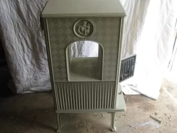

It is real hard to move move the flue collar on those old stoves, the bolts want to break. I would use it as it is setup right now. Oh, use Stove-Bright paint on that Jotul, don't bother using paint from a big box store, you will waste time and money. Here is an old Jotul I repainted with Stove-Bright.
