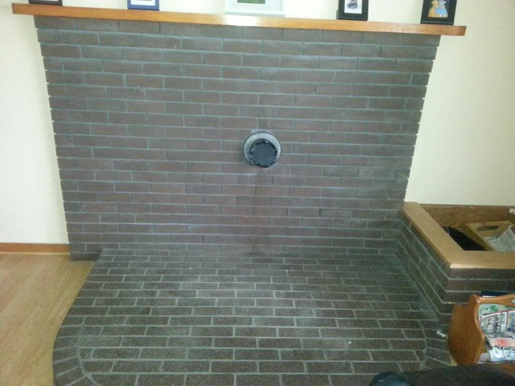

Wood stove removed, getting ready to clean the brick then await for delivery of our new stove.
Hope my picture shows up below :)

You're gonna need more than 50 bags!
Your wood stove is older than me. ;lol I have a P43 as well, you are correct about the daily maintenance, I went from cleaning the burn pot every day, to emptying an ash tray once every ton of pellets.
If I had any advice to share, it looks like your hearth is fairly long coming out from the wall, I'd try to keep the stove out from the wall far as you can. The back top cover (behind hopper) on mine is about 1ft from the wall, leaving about a foot and a half for the lower covers where the chimney piping comes out. Its just enough room to get to the panels to remove them and clean out with a vacuum, I'm 6'3 and 280 so I don't fit in many places taking that into account. Having extra room would be even better for me. You'll probably be around the same distance or a few more inches because you'll have a 6" coming out of the bottom, a 90, how ever much it takes to get up to the chimney, another 90, and an adapter to whatever size piping is there now.
I can walk the stove myself, but if I don't have to, it's one less thing. Especially if you seal/cement your piping.

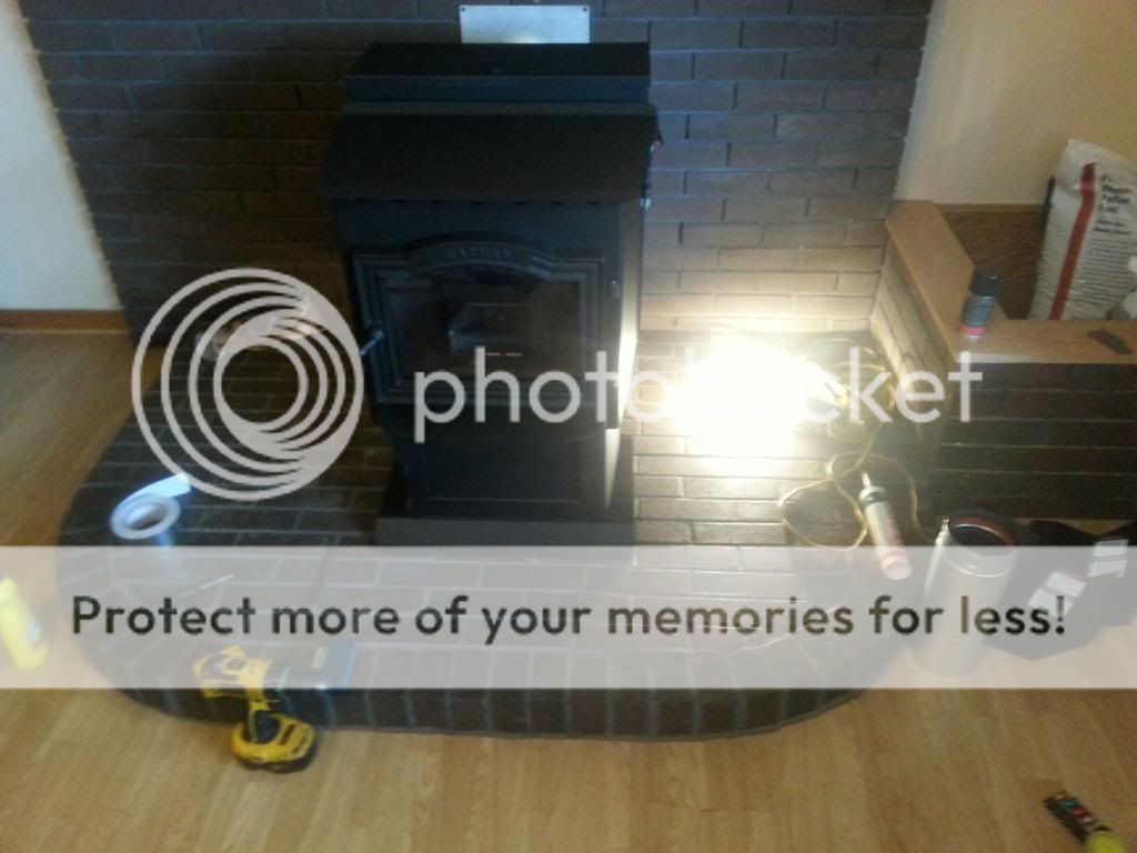

In progress

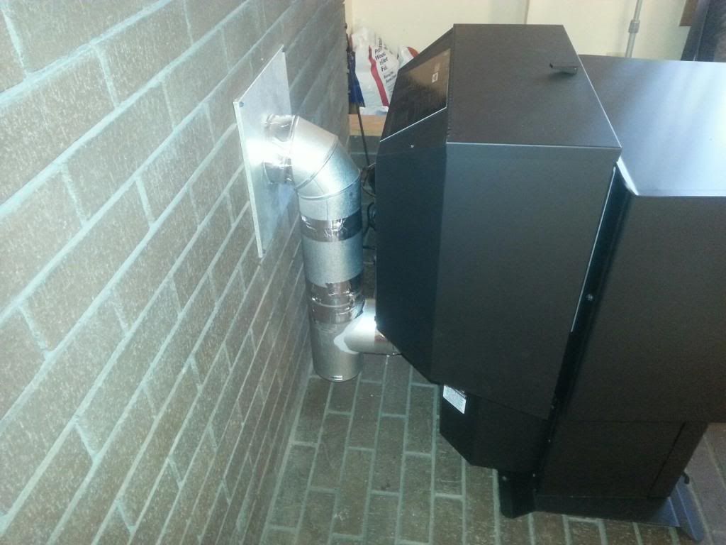

Back of Stove (Yes the joints are siliconed)

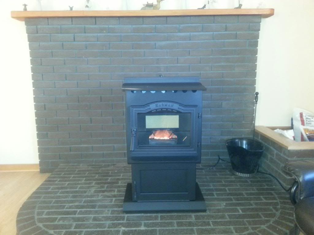

Install Complete & Fired UP
[Hearth.com] New P43 Harman Owner
Very nice. You're gonna love the stove/heat. I like the side area where a few bags of pellets can be stored. How come you opted not to go with an OAK?

Thanks, Don ;)
I did not go with the OAK on the suggestion of the installer at the store I purchased it from.
Hope to have more pictures later as it was too dark to take pictures without a flash.
And yes the wife is already talking about some trim and tile :rolleyes:
Thinking of putting a cover on the ``box`` to the right of the stove and dumping my pellets into it and using a large scoop to fill the hopper.

Do you have another pic? Hard to see how nice it looks with all the reflections
Unfortunately, no. Sold the stove to buy its biggest brother.
Welcome to the forum Fundy (as in the Bay of :)). Stove looks really nice in place. I added an OAK about two weeks after we installed our stove and am so glad I did. Something to possibly think about for the future... Happy burning.
