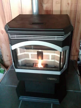

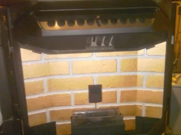

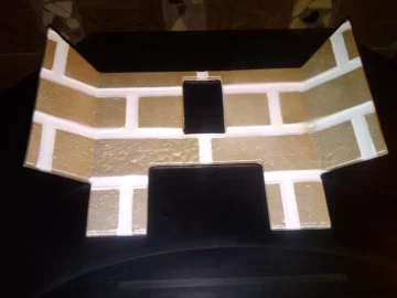

Restoring a Lopi Pioneer, one of my favorite stoves, used high heat primer on the cast panel, taped off the grout lines, used high heat flat Chevy red, misted over with high heat flat black, then removed tape. Ta da!

BEAUTIFUL! I love the 'touch' with the misted black!

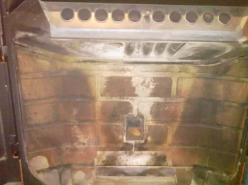

I should have snapped a before photo... This cast backing was in tough shape. The texture you may be able to see in the bricks was where the iron had lifted with all the rust and corrosion. Perhaps adds to the realistic effect now.

That is a gorgeous paint job.
gorgeous , but what happens after being exposed to firebox temps ?
I used a ceramic based 1300::F paint. Should hold up reasonably well if I can figure a way to cure it. The direction said to start the engine and let it run for 10 minutes then cool for 20 then let it run for 20 and cool for 30. At some point I guess I have to drive the stove around the block a few times.

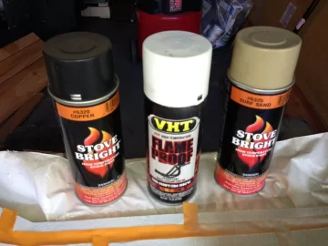

I used 2,000 Deg F header paint for the white primer and 1400 deg f Copper and Surf Sand color for a more modern look. :)

Oh and the trick here...you have to mist the black while the red is still wet. I did go over the black with the red and then back to black...all while wet to get the blending effect. Just in case you're fixing to try it out. Not hard. Just keep going back and forth until you get it.

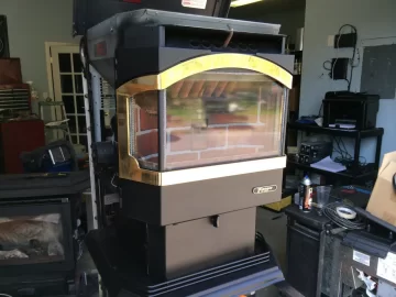

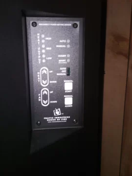

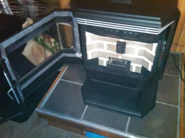

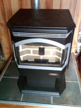

Here is the 1997 Lopi Pioneer I did 2 years ago. I updated the knob control to the Digital Panel.
Does yours have the knobs?
I also installed the Graphite Impregnated Door Gasket for that high quality look.
I went with the Flat Aluminum for the door trim and grill paint and Surf Sand on the bricks with Flat White between the bricks for that Up-To-Date look. :)

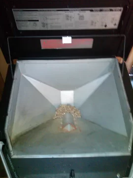

Coming together, new paint, new glass gaskets, polished and cleaned the gold trim, few more finishing touches and new door gasket and she'll be all newey.
It looks like it will be better than new when you have it finished. Thanks for taking the time to post the pictures and allowing us to follow along with the restoration.

Ahhh. My grille is just black. I also opted for the analog board, it was in great shape and I like it more....actually, it's still digital just has knobs.
