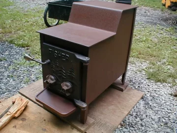

Looks like Bark Brown. (Stove Bright) You may have an original brown stove there like my Mama. It has a very primer dull look after years of use. Mine was black and when cleaned off, I thought it may be primer too. I've found when you wire wheel the sides, near the bottom you find the best original paint where it stays the coolest and is a good indication of what it was. Look for original paint on the back next to corner angle at bottom as well. If it was brown, chances are there will not be any black paint under the brown unless it was blasted. They tend to not lose paint there and get painted over.
Someone did the door of mine with stove polish which is difficult to remove, so I kept the door black polish and painted the caps to match stove. This is not the metallic brown. "Bark" is still available. It takes two cans.
