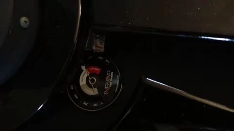

I did manage to get the top of the stove (inside the little opening where the air blows across) to 550degrees for a short time, but it's more like 350 normally, and where the air blows across, it's 290-300.
I have the stove top meter on my SIL's T5. In the pic, the left trivet top is swung open a little to show where the meter is, right in front of the flue exit. With dry wood, we see 600-700 here, once the new load is established and the secondary is firing good. We don't have the blower yet, however..

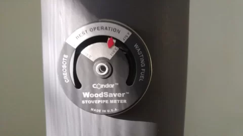

If you have single-wall connector pipe out of the flue exit, get a magnetic surface flue meter and place it about 18" above the stove top. It will give you more immediate feedback as to what the fire is doing. Once you familiarize yourself with what flue temps to expect at various stages of the burn, such as when secondary burn is starting, the meter will aid you in knowing when to start cutting the air back and how much as the new load catches, in order to maintain strong secondary combustion.

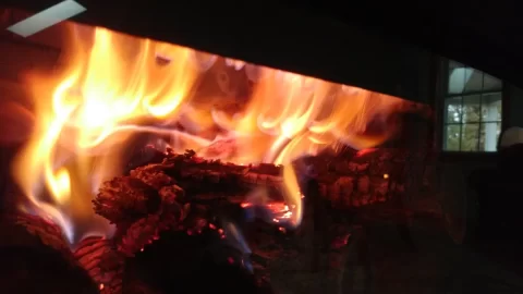

Are you seeing this type of strong secondary action, once the load is established and you've begun to cut the air? Flames igniting from the front and bottom air holes in the baffle?

Looks like both are built around the same box. but forget about the magnetic surface flue meter. ;lol The only way to get flue temps would be with a digital readout probe, with the display box out in the room.

You're right, it's a tough one to get a good surface to read the temperature. The Alderlea series door construction is different from their main line PE equivalents. The door size is full coverage and the gasketing is different. At the top of the firebox, right behind the door is the airwash deflector. This keeps the top of the door relatively cool. The best solution might be a digital thermometer with a remote probe on the flue collar.
