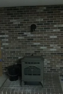

You should run a liner and or single wall pipe inside the flue to restrict the gasses from exiting the stove too quickly. You need this residency time to heat the exchanger propery and make the unit efficient. Quads can be vented up to 23ft using 3" liner if this helps on overall costs, but I would use a 20' run for good measure. The liner police are not going to yank the stove out of your house in NH like they do down here in MA. People vent pellet stoves into chimneys all the time without liners. Some work great, other not so well. Really depends on many factors such as chimney location, flue texture, size, draft, prevailing wind and other such.
Single wall is fine in a flue. Your clearances are to combustibles. If you are on a hearth and going into a hole to the flue, you need double wall PL vent or L vent to the connection.
If you use good quality pipe like PelletVent Pro or ICC your double wall pipes will have a manufactured gasket. I like to use an FTC connection at the hearth wall (Flex through connection) to join flex liner and double wall pipe.
You can do it man....it's easier than you think. The fact you are asking questions...and real ones...is a good sign. Good luck.

I understand about clearance to combustibles. I have attached a picture of my hearth. I believe that is not an issue. The base of the hearth is 48w x 60d.
I just want to make sure I am understanding everything.
For the correct install I should run a 3" liner down the length of the clay flue. Then all the connections in the house should be the double wall pellet vent?
Thanks

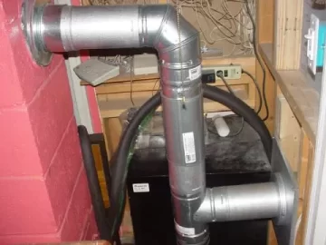

I found that in my case with an Inside 25' high cinder block 8x8 chimney with clay liner it works fine. However I talk to someone today who tried it on his 25' outside wall chimney last year and had poor drafting. This year he installed 5 foot pellet pipe and it works much better!
It seems that outside wall chimneys have too much cooler air to heat up as Scott said. A liner does help alot in that case!
The ideal situation is a 5 foot 3" diameter vertical rise in the house and then exit to the outside for the best drafting.

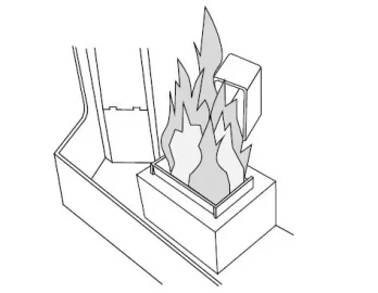

What were the symptoms of "bad draft"? Lazy flame?
Thanks
Yes, Lazy Flame which causes lower heat output of the stove.
If you have enough air you get a nice V shaped strong fire.
See pic below of not enough air - lazy flame
