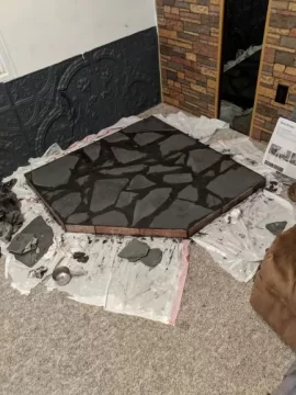

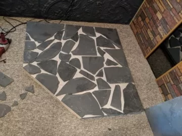

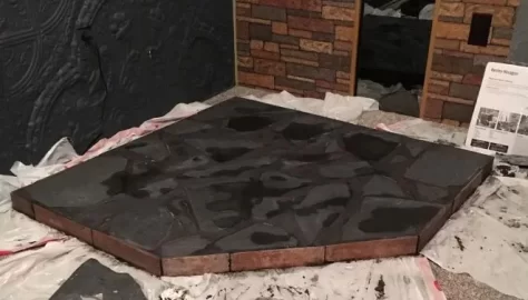

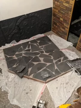

The hearth is two sheets of plywood, one sheet of cement board, mortar, stone tiles I shattered on the sidewalk, grout. ($90)

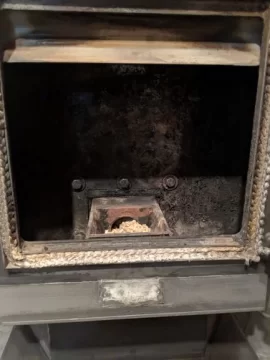

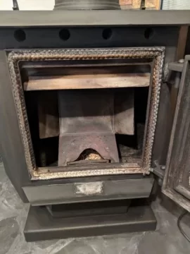

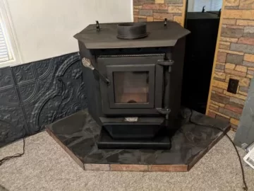

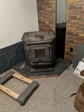

After 3 months I found a 1997 Englander 25-pfs ($100). Not bad shaped but not working. Needed a serious cleaning and a blower motor for the burn pot.
I would like to replace all bearings, auger motors and blower motors. But will see what budget allows.

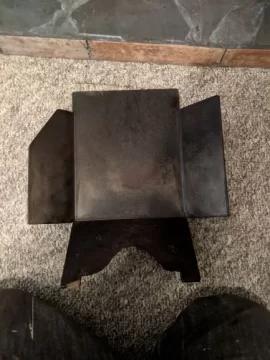

Am having a problem figuring out how that plate above the burn pot should be placed. Name plate says 25-pfs, but haven't been able to find any picks of this exact stove or that plate online.

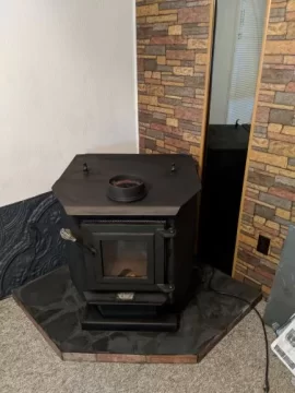

Including moving supplies, into this $250 so far. Will update pics and total cost as it continues.
