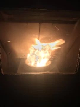

After cleaning everything again and doing a first fire start up sequence everything seems to be working again. The first fire seems to be really large however. I have the feed rod all the way pushed in on the lowest setting and the output on medium.
Got a picture of the high flame? By any chance did you get the dvd that comes with the stoves? It has a nice video on there of a "good" burn and a "bad" burn. This might be helpful so you know what you are looking for. Also I think quad has the same video on YouTube.
It definitely didn’t seem to get this high when it was installed. Doesn’t get to much bigger than this. After the first fire it seems to be fine. Maybe I’m just being jittery about the first fire.

thats a big flame. are the pellets your burning on the small side around a half inch long or less? did you clean out the trap door on the rt side? ash pan tightly sealed? the trap door shut above the ash pan?
I’m using Lingnetics Premium Hardwood. I’m not sure what you mean about the ash pan being tightly sealed. It just sits below the fire pot. I’m also not sure if your referring to the fire pot release/handle to clean as the trap door?
Sorry sawbeans the insert does not look to have the lower trap door or a latched sealed ashpan as the free standing does. I don’t have linetics in my area so I don’t have a clue how big or long they are made. You tend to get more pellets per rotation with shorter pellets vs longer ones. It may just be pellet brand and you can adjust your hopper feed lever to not allow so much in at a time. Close in small increments 1/4” at a time.
Typically they are at or longer than half an inch. The hopper feed rate is set as low as possible. It seems like it’s just dropping a lot of pellets on start up and the fire isn’t starting for about 3 minutes.
