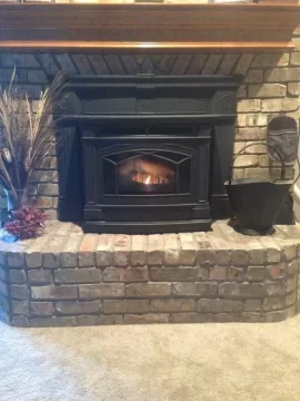

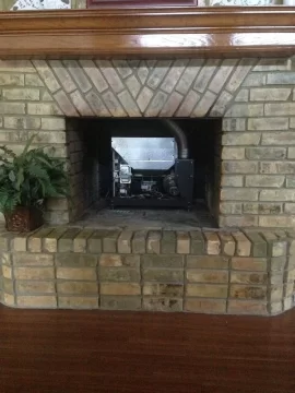

oh and someone requested a picture - we installed the insert in a double sided fireplace. We are going to make a removable tiled wall on the backside which is viewable from our sun room.

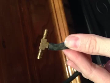

The pressure gauge came today but I'm a little confused. I tried looking for a tutorial but didn't find what I was looking for. The gauge has rubber tubing and I connected that to the lower valve on the gauge. The other end of the tubing has a T shaped copper connector. The base goes in to the tubing, and I'm assuming one end goes in the hole in the front of the stove but do I cover the other part of the t with my finger or allow air to flow through? [Hearth.com] New Regency Hampton GCI60 not blowing hot air
not sure what that copper connector is but dont think that will work.an inflating needle that you would use to inflate a ball will work if you have one.if not then an auto store will have a kit that has 1/8" copper tubing and adapter that you need.i think its for testing oil pressure or something along those lines.
