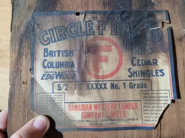

Interesting photo. My house also has cedar shake under a "modern" roof. I don't know the age of the shakes, that part of the house is a 275 year old addition atop a 290 year old lower structure, but I'd be surprised if the shakes are that old.
What's interesting about your photo to me is the complete planking under the shakes. I have spent a lifetime in old houses, old church buildings, old barns, etc., and I have literally never seen one with full planking beneath cedar shakes. In fact, if you had asked me prior to seeing this, I'd have guessed that planking might even interrupt the surface tension that makes a cedar shake roof work, as I'm sure we've all seen the way a water droplet can find its way to the bottom side of the gap between two shakes, only to be ejected back outside by the one below them.

Our old farm house was built in the 1890s. I installed a standing seam metal roof about 6 years ago. What I found during the tear off was 3 layers of asphalt shingles and cedar shake under that. I also found complete planking. I attached a pic from one of the cedar shakes.[Hearth.com] New roof on 160+ year old house
