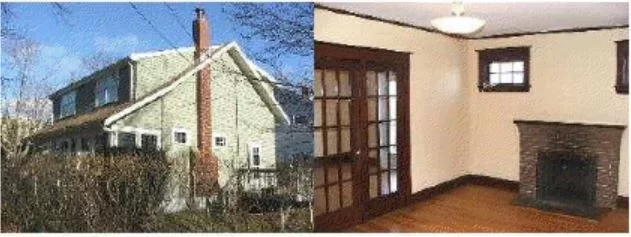

Hi folks, great forum you have here. I've been lurking around doing as much reading as I can... very useful!
We are planning to put a Regency i1200 insert in our old open fireplace. Our house is a 1924 arts + crafts 2 storey house in Nova Scotia, with an exterior chimney (see photo).
The chimney is in bad shape, so is getting repaired/repointed and lined before we install the insert.
The WETT-certified mason/sweep said we could use a 5" liner, because our chimney is high enough to compensate for the smaller diameter flue. This would also save us the cost of breaking out the existing clay liner (~$450). The Regency documentation says 6" is the min.
Does that raise any alarm bells with you folks? Has anyone else got a similar setup (undersized flue, small insert, tall chimney)?

Depends upon height of chimney. Normally one does not go smaller but some have and have done okay.

5.5" is usually the smallest you should go, your chimney looks to be about 20-25 feet tall which 5.5" would work, not sure about 5". Whichever way you go make sure that liner is insulated since that is an exterior chimney and the flue probably has cracks, not sure about canada codes on cracks and liners needed to be insulated.
Also be aware that with a small firebox you will be feeding that insert often. If it was me I would extend the hearth and install a freestanding stove with a rear exhaust. A brown woodstock stove would look very nice sitting in front of that fireplace. Here are some pics you can see what it would look like: (broken link removed to http://www.woodstove.com/owner-photos/stove/4)

If the chimney liner height is >30ft, 5" should be ok, especially if insulated. I'm more concerned about the insert size. Is this the largest that will fit? If you can provide full dimensions front and back (and depth) we can see if there are alternatives.

Sizing/stoves - multiple constraints here...
1. Fireplace dimensions are on the small side - 27 3/4" w x 25" h x 17" d. Tapers to 25" w at the back. Looked at the Jotul C350, but it's too wide.
2. We have two young (<2y.o.) kids, so being able to fence off the fireplace is necessary, and that's easier with an insert than with a stove
3. Aesthetics - it's a narrow room, and we don't want to lose the floor space to a stove
4. Budget - we don't want to get into hearth extensions/pads etc - spending enough on the chimney as it is!
Liner - thanks also for the comments on the liner, feeling slightly better about the 5" now, but will have to confirm the exact height first.
Hi lostandconfused, that looks like a really nice craftsman home. We have one as well with original unpainted chestnut trim throughout. Are those divided light doors sliding or swinging? We have sliding ones in our dining room - truly beautiful craftsmanship.

Regarding liner size - 5" diameter is only 2/3 the inside area of a 6" liner. I would personally stay with what the stove manufacturer recommends as much as possible, especially if you have a tall chimney (>15 feet high). An extra $450 now is cheaper than a new $1500 liner later. True - everything may work fine with the 5" liner, but it also may not. Think of the $450 as good insurance on a successful install.

Have to disagree. 5 or 5.5" will be fine with a 30ft flue. We see several folks a year here that have inserts with long 6" liners asking how they can install a draft damper in the liner and find out they can't.

Check out Duraliner 5". No chip out needed.
Your doing it all wrong if you look at a freestanding that you can squeeze into the fireplace, you want one with a rear vent that will back up to the fireplace opening, like the woodstocks that I posted, there are others out there that do rear vent and are made just for this application.
As for the liner, you never did say how high that chimney is, that will be your foundation for if you can install a 5" or 5.5" insulated liner.
