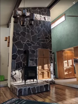

Vaulted ceilings are no joke, it takes a lot of output from the stove to fully warm up the room. I'm learning this as we speak, having just installed a new Jotul F55 in our living room and the nighttime temps are dropping into the 15-25F range. The ceiling fan helps a lot (set to push air upward, flushing the warm air back down).
