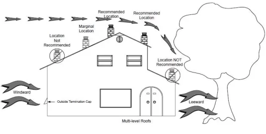

Or it could be the cabin is in a particularly windy area where the wind is tunneled toward the roof. Is the chimney higher than the roof ridgeline? Chimney location can sometime be affected by location. Here's an illustration of some location issues.

Also, make sure your chimney honors the 10-3-2 rule.
Wow, those are great illustrations!
Our chimney is on an outside wall, but nowhere near being higher than the ridge. I think it conforms to the 10-3-2 rule, but it would have to be another 10-12 ft high to be above the ridgeline. The good news, I guess, is that is on the windward side of the house, and the wind coming off of the lake is pretty steady and predictable under most circumstances (unlike the other night!).
Thanks again!
The top of the pipe doesn't have to be above the ridgeline as long as it is 2 ft higher than any building point (roof in your case) within a 10 ft radius.
I think it meets that standard. If not, it's very close. I'll check the next time I'm up.

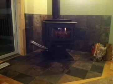

I found a picture of the set-up. It's not very high-resolution, but you should be able to see what I'm talking about.
The double wall doesn't start until 2-3 inches off of the top of the stove. It's just a bit below the line where the slate ends in back of the stove. That's where the smoke was puffing out when the wind was blowing. You can also see the OAK supply from outside. The pedestal stays understandably frigid, and I think is probably what keeps the blower thermostat from kicking in, but that's just a guess.

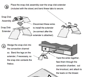

Next time you are up there take a look at the blower's thermostatic snap switch. Usually there is a spring steel piece that presses it against the stove. Try to increase the pressure on the switch by rebending the spring if you find the snap switch loose.

The thermostat is not attached to the stove. It just came as a separate unit that's apparently supposed to sit on the floor. The cord from the blower to the control is so short it can't even be mounted to the wall in back of the stove. I am trying to find a way to attach it to the heat shield that will keep it off the pedestal base -- right now I just have it resting on a log.

Can you see the double walled pipe starting a couple of inches above the base? Does that seem legit?

That doesn't sound right, the blower switch is free floating, but the blower thermostat is mounted on the stove body. To see what I am talking about, go to page 35 of your manual.

I do see the pipe and it too looks odd. Mine is nothing like that.
That doesn't sound right. We'll need to see some shots of this. Is it supposed to be a factory unit?
Yes, it's supposed to be a factory unit. It came in the box from the retailer.

Read the manual, page 35.
I just found it on the Travis site.
I don't think this is the same manual that I have (I don't remember the section on the snap switch), but I'll print these pages up and take them with me.
I assumed the thermostat was in the controller with the rheostat; I'd never heard of this snap switch until you mentioned it earlier.
If this works the way it seems in the diagram (the snap switch is the thermostat, right?), then I bet you are right, that it might not be in contact with the floor of the fire box.
I'm excited to go take a look at it. Thanks a lot for pointing out that page in the manual to me (I've read the manual, though maybe just read through the blower entry and not this bit at the end).
Yep. And it makes no sense for it to be sitting on the floor. The cord is short because it only needs to be long enough that you can pull it out for maintenance.
I think the part sitting on the floor is the rheostat/switch box. The thermostat should be on the underside of the stove. Follow the wires with the stove blower unplugged.
Note that even with greater tension on the snap disk spring, the fan will take a while to come on the first time. Once the stove body is thoroughly warmed up, it should then stay on.
