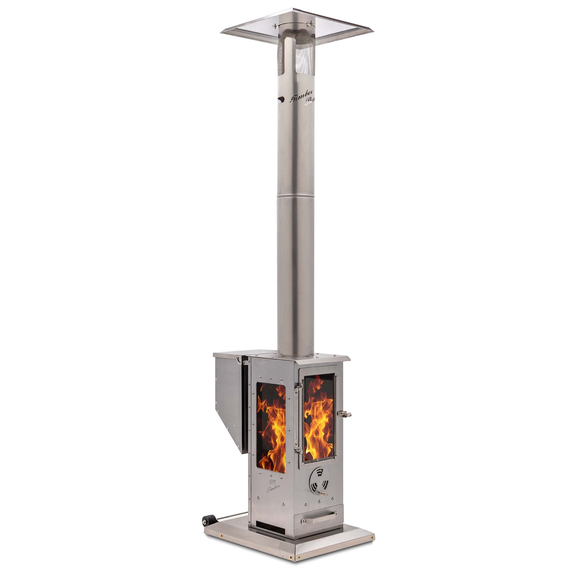

Where in the world can I have one of these?? They obviously exist, but are rare....
[Hearth.com] New Stove!  First Stove!  And it's outside :-)!
Still debating, making progress on the wall though!
May go with a Wood Pellet Products gravity fed stove and run it through the wall. Class A pipe from stove. Only requires 3 feet at termination from combustibles and very little height (6 feet) for draft. I could then use one of those angled thimbles and run it straight out of the wall at an angle and terminate 3 feet away from the deck. No chimney to see anywhere, in spec per the manufacturer, and the fire ambiance plus the heat. I’ve used one in person and they throw a huge fire in them and really pump out the heat.
[Hearth.com] New Stove!  First Stove!  And it's outside :-)! [Hearth.com] New Stove!  First Stove!  And it's outside :-)!
Where? Can’t find it! What’s it called?
Last I looked it was in the ventis catalog. No idea what it's called never ordered one or had any reason to
Ventis makes one. Why would you need one?
I have seen them permitted in Canada where they have a 45º chimney elbow, but not in the US.
Any idea what the 24" tall stack is off the flue collar on that stove?
