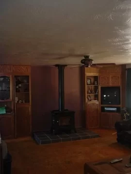

New stove installation..makes existing ceiling fan too close to stove pipe
JPapiPE
I used to have a vermont castings propane gas stove. The former owners put a ceiling fan in close proximity above that gas burner, but I sold that stove to buy my Englander 13NCH. It seems now that the extreme ends of the blades will not have the 18' clearage from the wood stovepipe(24ga). They will and they won't. Let me explain... If I turn off the fan and one of the blades comes to a stop in the wrong place it will only be 9-10" away from the stove pipe. I realize that a ceiling fan is probably better than a stove mounted fan, so I considered moving it, but after looking at the electricals in the ceiling that the former owner did...it was pretty scary. Plus my attic is only a low pitched trussed roof with only crawlable space overhead. Also there is no floor in the attic only trusses and 3/4" strapping in the area I would have to work. I see this fan placement as an unsafe condition. I might prevent this problem using double wall interior pipe from the stove to the HT double wall chimney insulated stuff. Do i have to bite the bullet and do some electrical work which would probably take a whole day. Or buy the englander stove fan or is there any other way to leave the fan where it is and be safe. I guess i dont know the cost of double interior pipe...I'd need maybe 5 feet to the chimney pipe. Should i use the double and save myself the aggravation of moving some hackers electrical job? I' sure if anything kills me in this mobile it will be the wiring before the stove. Sorry about so long a post.

If you have a mobile home, code requires double-wall connector from the stove to the chimney support box at the ceiling. If you swap out your single-wall connector pipe for double-wall, you'll eliminate that code violation as well as the clearance violation to your ceiling fan blades (double-wall connector pipe only requires 6" clearance to combustibles).
The HUD listing requires that you use the same brand of venting from the stove to the cap, so determine what brand of chimney you have and buy that company's connector pipe. The basic piece you need is what we call the Trombone: this piece is in two sections that slide together to create an adjustable length, usually 40" to 65" or 68", which should get you from your flue collar to your support box. Depending upon the thickness of metal used to make your flue collar, you might also need a flue collar adapter.
Even if you need the adapter, the whole shebang will run you less than $200.00, and will offer these advantages over your current setup:
It will eliminate your 'single-wall pipe in manufactured housing' code violation
It will eliminate your 'ceiling fan clearance' code violation
It will keep your flue gases warmer, improving updraft and reducing creosote formation
It will save you the hassle of periodic stovepipe replacement (the inner wall of double-wall connector is stainless steel)
It will look better (only one pipe joint between the stove and the ceiling)
It will save you the all-day hassle of moving and rewiring your ceiling fan

You can buy shorter blades for the ceiling fan if you decide to not do the double-wall Tom is suggesting.
I used a double wall trombone in my installation. It was slick as heck to attach the stove to the ceiling. Looks good and allows easy disassembly if you ever need to. I also moved a ceiling fan away from my stove by about 4 feet. It involved a days labor but I used superior methods to install the fan unlike the previous homeowner who hacked the electrical and hacked the fan support structure. The new fan is now centered in the room, centered to the stove, etc. Just like it should be and the wire is not laying across the attic with two wire nuts in the insulation (who needs a ground?).
