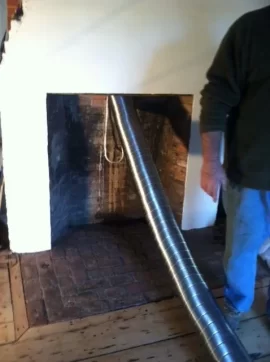

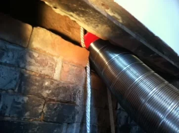

Our chimney is a giant beast with a cementboard top cap over the 5 flues so we had to pull from the bottom. I made a pulling cone out of a piece of 2x10 which ended up I think making the difference on the amount of effort getting the liner up, being able to keep the liner centered in the flue so it wasn't dragging or getting caught on the bricks, PRICELESS.
Before the pull:
The pull when MUCH easier than I thought and I was able to use just my strength pulling and my falther-in-law guiding/pushing it up from the bottom. Before I knew it it was at the top!

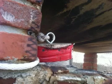

I put the top plate on to hold the liner and then the next day (sorry I didn't have my phone) we poured loose fill perlite (mixed with concrete at the bottom) to insulate the flue which worked awesome and was pretty inexpensive, especially compared to some of the bagged insulation found at chimney sites.

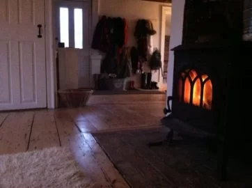

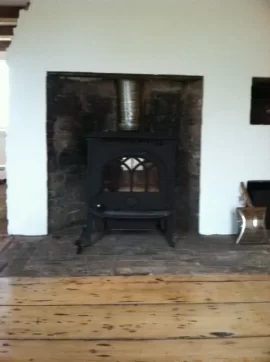

Here is the final install:
A little hi temp paint on the liner and it will be done!
