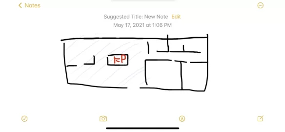

We have 1000 sq feet of our ranch that we completely opened up with the fireplace right in the center. Costal SE North Carolina. The 3 beds and two baths upstairs are another 1000sq ft. Our 1.7 cu ft F400 is too small for the coldest nights, 25 degrees and lower, and just right to carry 100% of the heating demands most other times but it needs to run 4-5 loads a day when it’s cold. (I don’t burn high btu wood).
So don’t just assume you need/want a small stove. We like stove pizza night.
