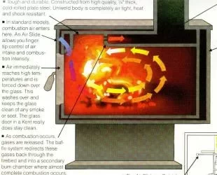

In an earlier post I praised the simple design of my 1986 Kent Tile stove https://www.hearth.com/talk/threads/38654/ and see pic below. :)
However, I discovered that I'm generating about 4 times the particulate matter of today's stoves - I guess things were too simple :-S
My question is :
What new stove has the simplest design with least damageable/moveable parts ? (I'm thinking of this thread https://www.hearth.com/talk/threads/38442/ )
And maybe ..... what new stove would come closest to matching my Kent ?
Thanks in advance

I have burned a Kent Tile Fire and a Lopi Endeavor in my my own home and in my shop. The Endeavor is the closest in operation to your Kent. One air control, one flue by pass for starting and refiring the stove just like you are used to. EPA tested at 1.9 grams hour and a little bigger firebox for a little extra heat on those cold nights. You could also look at the Lopi Republic 1750. It's the same firebox with no frills and no flue bypass at a real nice price.

As a Kent owner, you're going to be very hard to please. If you want a stove that's the same size and shape as your Tile Fire, will install on the same hearth with the same clearances, and will hook up to the same connector pipe without modification, I'd recommend the Pacific Energy Super Series models, which can be viewed at (broken link removed to http://www.chimneysweeponline.com/pacific.htm).
Looking at the Super Series firebox, it is as if PE took a Tile Fire and added preheated secondary combustion air, ceramic blanket insulation, refractory firebox liner and smolder-proof draft control, while eliminating the need for the bypass mechanism. The result: a stove that loads and burns just like a Tile Fire, but achieves 69% efficiency at 3.4 grams/hr. Wood in, ash out, couldn't be simpler to operate. And all major components are covered by a lifetime warranty.
When my Tile Fire bit the dust, I installed a PE Super Series Spectrum, and am still burning it 16 years later.

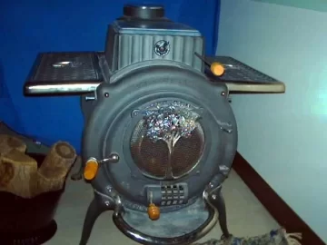

The Vermont Iron Elm Stove is still available and it has a door and a butterfly air control mounted on the door. Check out the videos on you tube. I plan to buy one as soon as I can. Tax credit be dammed. One need not look further than GM and Chrysler to see what happens when you accept hand outs.
Bushman
HehHeh . . . looks like a cast iron air-o-plane. :) ;)
Generally speaking, stoves made of steel are much more simple than those made of cast iron. The steel stoves are welded together while the cast stoves tend to be bolted together with gaskets between each piece.
If you want simplicity, stick with non-catalytic steel stoves that have one control, one door, and no ashpan. IMHO.
