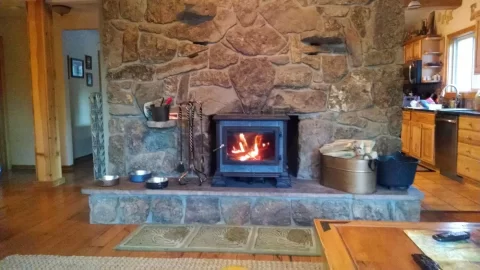

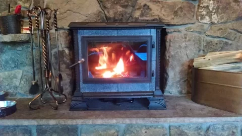

I considered the Homestead when I was looking for a new stove. Nice-looking stove! :cool: We wouldn't mind a pic or two... ==c

Pictures attached 4th Break in Ready to go.

That setup looks very nice Snowdawg! Beautiful!
That a great stone stage you have the stove on. It looks great. So does the house.
Thanks for the compliments. The house has been a labor of love for both my wife and I for sometime.
