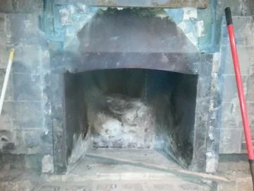

I am cutting out an old heatilator insert and I should be able to fit a large insert. I am on a tight budget i would like to stay under 1500. I am overwhelmed with the choices if anyone have any good sugggestions i would appreciate it.
what do you mean you are cutting out an insert? Inserts just slide in are you referring to a metal firebox of a zero clearance unit or what?
I'd remove everything and put in a freestander. I've done it and many others have as well.
My understanding is that as soon as you start modifying the basic structure of the ZC fireplace, it loses its UL 127 rating and is not qualified to receive an insert. All that is allowed is the removal of the doors and damper. Regardless, the budget is very tight to do a proper install. An insert must have a stainless liner.
How tall is the chimney and what insert is being considered?
Reactions: jotulguy
Currently the doors are off and the only damper is the one on top of the chimney. All I want to cut out is enough to slip the liner in and the slanted area in the back if that's legit I'm not really sure.
Do you know what Heatilator model this is? I'm wondering if it is a masonry form or a true ZC insert?
is this inside a masonry structure feeding into a masonry fireplace?
This is what is left

What did you do to that poor fireplace lol.
Well I just bought the house and the guy that built the house was somewhat of a hack to say the least so I'm trying to get rid of the Brady bunch look and do things right
Well as long as there are no combustibles around that which it doesn't look like there is and you rebuild it right there is no reason you cant drop a liner and slide an insert in there. But $1500 is that for the stove and liner if so good luck.

That looks like a masonry form. If so, I believe it's safe to open the slope for the liner.

Oy, I'm concerned whether that is even a legal fireplace anymore with the Heatilator form removed.
