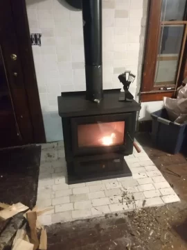

I see Menard's claims 8 hour burn times. I would think after you figure it out and get used to it you can get close to that. Guarantee you can make it burn longer than 1.5 hours, ha!I know that this is a cheap Chinese made stove. It's what we could afford right now. Can I expect to be able to do overnight burns in this? My old coal stove would burn a full load in like an hour and a half

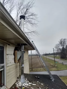

How tall is your chimney?Really exited house is warmer and used about a quarter of the wood I usually would have in a night
You'll see the secondary flames up top mainly the first hour or two...after that it will be more so primary flames or just red hot glowing coals.With a non cat epa stove should I have my air set to where I constantly see secondary flames? Or should I chit air down completley once it gets up to temp and a good coalbed is established?

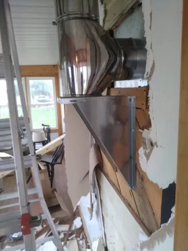

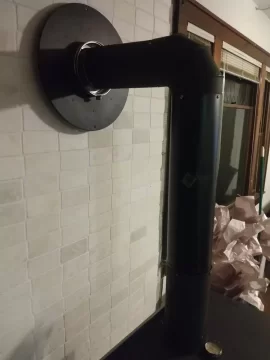

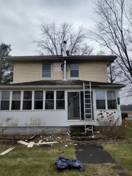

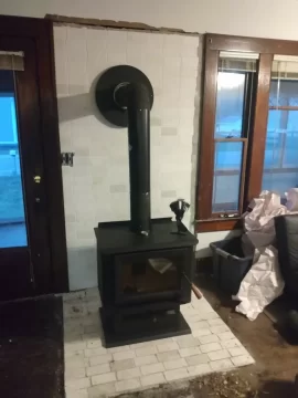

Looks good...that'll work for sure...wouldn't be surprised if you would benefit from a manual damper in the pipe 18-24" above the stove there...not totally necessary, but could extend burns a little longer and put a little more heat in the house, especially once the weather gets colder and the chimney draft stronger...like I said just based on my experience with a EPA VZ (Defender) but I think they pretty much are all easy breathers so...Have 3ft to a 90 to a ft of single wall. Then a Selkirk through the wall kit. To a 90 tee. Then about 20ft of Selkirk ultratemp pipe
View attachment 287985 View attachment 287986 View attachment 287987 View attachment 287988 View attachment 287989
Thanks for the helpLooks good...that'll work for sure...wouldn't be surprised if you would benefit from a manual damper in the pipe 18-24" above the stove there...not totally necessary, but could extend burns a little longer and put a little more heat in the house, especially once the weather gets colder and the chimney draft stronger...like I said just based on my experience with a EPA VZ (Defender) but I think they pretty much are all easy breathers so...
Ran it hard all weekend. Last night stuffed it decently full at 11. Let it establish itself then shutdown air. Woke up at 530am to full bed of coals and stovetop temp of just under200. So with some better wood and maybe adding some small splits to fill in air gaps. I could get 8hr. Thanks for help guysWith proper loading and operation it should be possible to get an 8hr burn repeatedly with that size stove. Keep us posted on how it works out. Key to success will be having good, dry firewood. That makes a very big difference.
