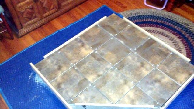

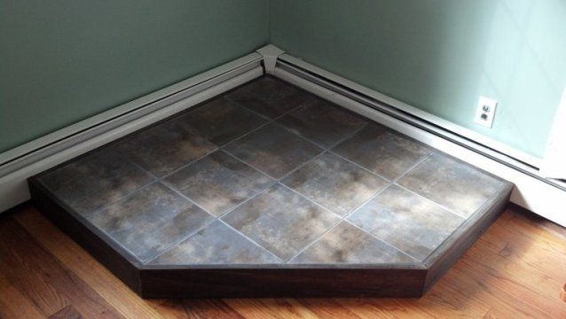

I'm also in the process of making DIY hearth pad with tiles.

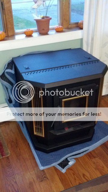

Here she is...
