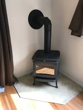

So let me start that I’ve been burning for at least 7 years. I just got rid of a Napoleon 1450 which went up through the center of the house and moved to the corner of the living room with a PE Aldrelea T5. The stove was installed today, double wall inside and about an 18’ chimney outside. I decided to do a tiny break in fire and I’m having a hard time getting it going. I’m using fat wood and a couple pieces of split down 1 year seasoned maple. I have it all the way to “start” but it will go for a little bit then die out. If I hold the ash dump open it gets going great. Weather outside is about 60 degrees which may affect draft. Any ideas why it’s a pain to get going? My Napoleon would light up without issue.

The 90s knock off like 3' effective height each, so that will have some impact vs your old straight shot. That being said 60 degrees isn't helping either. I've found in my new install that it looks like around 55 degrees is where I can get an easy start. Started a fire at 67 yesterday (just a break in burn, wanted to be able to keep the windows open) and it was difficult to start.

Center of the house, straight-up flue is ideal both for heating and draft. It's hard to beat a straight up chimney for good draft, especially with warm outside temps. It's the 18" horizontal section combined with two 90º turns creating resistance. And the outside flue is going to be colder than the indoor run was. Does the stove start ok with the door cracked open until the flue has warmed up? If so it should be better tomorrow with cooler temps in Rochester predicted. And even better as temps drop below 50.
