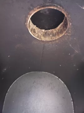

I found a semi-local guy who has a Heatmor used for sale. It has a small pin sized hole at the top of the firebox. Is this something a skilled stainless welder can fix? Is there anything else to looks for? I am trying to purchase on a budget and do most install myself with help of others who have a boiler. Thanks.

The Heatmor is a 409 tank. Not difficult to weld. But with one pinhole it may have electrolysis issues going on with more ready to come through. My experience is if it has brown sludge in the bottom don't touch it. It's hard to say though what is going on in it.

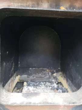

Here are 2 pics the seller sent of the firebox.

Looks very clean. Has it been burned much? What year model?
It'd be interesting to see more pictures. Records of water treatment tests would be great if they have them.

Not sure about water tests. This person "just" moved into the house and is using a wood stove. Thus why he is selling it. States it hasn't been used for a few seasons.
Hmm, maybe that's why it looks lightly used.
It's like buying a used car. You look it over real close and take a chance.
Went ant looked at the boiler. Looked clean other than a boil over. It came with pump, blower, t-stat, and some other things. I ended up getting pretty cheap, $300. so worth the gamble to me, and I hate gambling! I will have to take a closer look at the pump to see what size it is, but I am looking to install about 100' or so away from the house, maybe closer. Going to put a water to air exchanger in furnace. Also, going to run 2 extra lines for garage hook-up as we have a $$$$ electric heater in there too.
