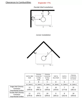

The problem with such a small space is that only a small stove will be required, but small stoves usually have short burn times. That could mean feeding the stove every few hours to stay warm. That said one stove to look at would be the Englander 17VL. It is shallow, has reasonable clearances and is low-priced. It normally requires a 15ft chimney, but at 9000 ft I suspect it would be happier with at least 20-25ft of chimney. There is no hard rule here. Different stoves breathe their combustion air at different rates. The other stove that would be good, but maybe a budget breaker would be the Blaze King Sirocco 20. This is a catalytic stove that can be run at a low and slow rate for long burn times and heat.
Download the manuals for these stoves and look at the alcove installation requirements. Pay attention to all dimensions including ceiling height. Also note all mobile home requirements. My concern with doing an alcove for the stove are clearances and support. Wood stoves are hot and heavy. The alcove ceiling would need to be strong enough to support several lengths of heavy chimney pipe. You may want to think twice about this route given the temporary nature of this dwelling. It simply may not be worth the investment, you'll have to weigh the cost benefits. The stove is going to run between Some of the parts could be reusable in the new home like the chimney and the stove.

I am printing all of the manuals so we can read them this weekend. I had looked at the 17VL, but couldn't find any ratings on it on this site and wasn't sure if it was too small for our needs. Do you actually build a chimney 10-15 feet above the roof line? How is that supported? Our neighbors just moved up there full time, so many of these issues are far more imperative for them. They are not strangers to wood burning and high altitude, but total newbies to RV living. We are working hard to get them as insulated as possible before winter. I need to say how glad I am to have found this site. Time and again I see how helpful you all are and the great ideas just pour in. As for Daniel and I, we might just go with the propane until we build and add the stove then. I am not one to play with fire...literally.
There are several threads here on that stove. Search on 17VL ( or 17-VL). It is a decent small stove.
