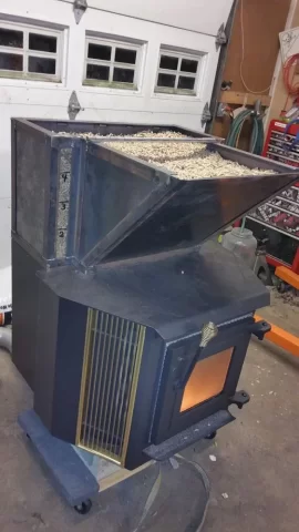

I just picked up an englander 25 pi,manufactured date was 93 so it has the 2 analog dial control board.i built a stand for it along with a bigger hopper as I won't be using it for a insert. The knob for the room air blower doesn't seem to be working right,it's practically an on or off switch,no inbetween. I don't believe this is right but it's not to big of a deal for me as the stove stays in the garage. I know I can upgrade the board to one of the newer ones I believe but I'd rather keep this one or get it repaired if I could. Is there any benefit to upgrading to the newer board over the old style like I have if I can get this one repaired cheaply?
Here's a quick shot of the hopper before I got the lid done and the hopper painted
