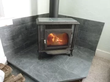

I am a new member here and over the last 2 months got some valuable information from this site on hearth building and some other install tips. I just installed a Hearthstone Starlet on a raised hearth covered with quartzite. Chimney is excel. Thank you to everyones posts I browsed and for all the knowledge I gathered from this site. Here is a pic of the work so far. Going to go a little farther up the wall with the stone. [Hearth.com] New to me Hearthstone Starlet  installed, thanks to this  site for the info

Hey Holiday, welcome to the site. Lots of us started with information gotten here. Nice setup you've got there.
Love the stone work on the hearth.
Nice!
1st stove ever?
Nice stove and very nice hearth!!!

Nice job Holiday!!!!!!!!!! Welcome aboard, keep us posted.:cool:

Nice looking install Holiday and Welcome! I really like the quartzite, especially the "subway" brick style backsplash.
That looks great. I added the stove name to the title. We don't see it that often. What can you tell us about the stove?
Thanks, I cut all those from the full tiles. Turned out well.

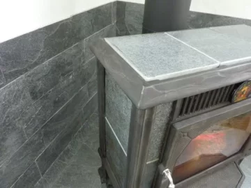

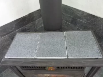

It's basically a cast iron stove with removable [Hearth.com] New to me Hearthstone Starlet  installed, thanks to this  site for the info soapstone tiles placed around it for looks and some heat absorption. It's 40000 btu, 17" logs, 1.6 cu ft firebox, so not an overly large stove. This one is a 1997. I found it used in British Columbia but it's in excellent shape.

I like its clean lines. How does it reburn, secondary tubes or cat?
It has secondary tubes.
Thanks. It sounds like the predecessor to the Homestead.
I agree. It looks and sounds similar to my Homestead. Nice install!
Yes, it probably was. I see they now have a solid soapstone firebox. They must have a very nice heat coming off of them.
