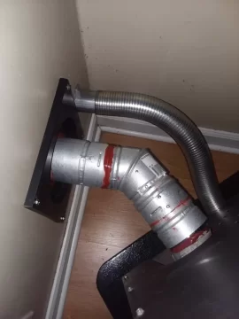

I recently purchased a used Englander 25-pdvc (2003) and installed it this weekend. Maybe I'm over reacting but the pellet vent coming off the back seems hotter than I expected. I'm venting with the 3" pelletvent thru wall kit with a 45° off the appliance collar before exiting house. Am I over reacting and this is normal?

How hot is it and what were you expecting?
If I remember correctly exhaust get hot. Be sure you are matching fan and burn rate. 5-5, 7-7, etc on the control board. I think they also have some settings A B C. Check which setting you should have. I Know different settings can burn hotter than other. If you don't find any information here, contact them.
Some has the three numbers on the bottom are 6-4-1, but check for your year model what should be.
The exhaust pipe on my stove is cool enough to touch, but hot enough you wouldn't want to keep your hand on it for very long. It's a little cooler than the top of the stove gets when warmed up.

I checked my pip temp today and it's 250°F at exhaust blower exit. This seem ok? BTW, this was at a 5-5 setting running about 20 minutes.
Your pipe temp is going to fluctuate with your settings, you could try dropping the heat down to 4 and fan up to 7 and take the heat out of the stove for your living space instead of sending it up the chimney.
