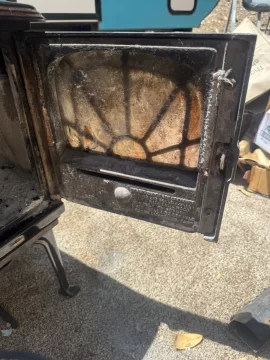

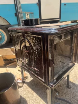

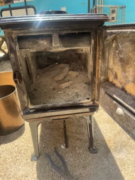

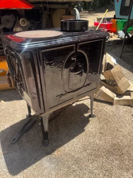

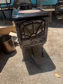

Precaud: I see it’s been several years since you have had much conversation regarding this Waterford model 33 wood stove, but I just found one in an abandoned house and it’s actually in amazing condition considering the situation I found it in. I’m having a hard time finding a manual and a schematic so that I can restore it properly. Do you have any suggestions as to where I can find what I’m looking for?
Here are the pictures, I just cleaned the outside so far.

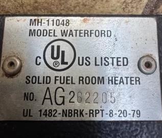

I will move this thread to the main forum for wider discussion. The Leprechaun was a nice stove but I don't recall seeing a Waterford model 33. Can you post a picture of the UL label on the back of the stove for further identification?

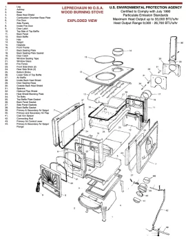

If's it's a 90 then here is the parts diagram. Woodman's has some parts, but not the broken left, front-side brick. You may need to cast or cut your own out of refractory material.
[Hearth.com] New to the forum - Waterford question
