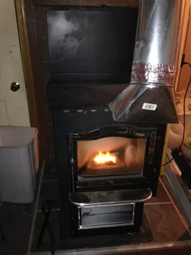

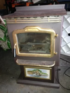

Hello, Wanted to give everyone an update on this. Today I took the door off of the PC45 and put it on the P61. The hinges and the door handle line up but there is one issue. The pin / arm is too big for the cutout in the stove itself. It looks like the rope gasket and everything else would seal properly. The pin piece I know is removable because years ago I had to replace the glass in the PC45 because I broke it and had to replace it. I'm thinking that is all that would need to be done to the stove to get the newer door to work. Has anyone else tried this?
I had an older P61a that was honey brown with the old gold door. The new style door fit fine. I also got a new ash door with the recess for the tile but also had to get the new skinny ash pan that would fit with the new ash door then I got the Nickel Trim kit and a scenic tile. I also painted it black and put an extension on the hopper to be a 2.5 bagger. :)

Hi Don, That really dressed it up quite a bit! Can you please tell me where you got the door from? Was it online or through your dealer. I would be looking to do the exact same thing that you did. Very nice work!
Thanks
Yes, that fire door must be ordered thru your local Harman Dealer
Actually you can also get it online from someplace like Stove King, but if you are unsure of what exactly you need, your dealer is probably best.
