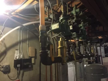

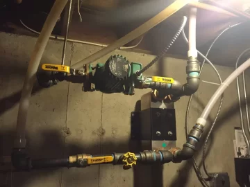

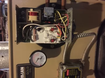

The top pic is the furnace aquastat and temp gauge. The second picture is the pump and heat exchanger and the in/out piping. If the pictures don't help I wish I coukd exain more but like I said this is all new to me so I'm learning as I go. I have a general grasp on the concept and the piping but could prob only describe/explain it to a degree.

I usually put in an armful of solid size split seasoned hardwood. Overnight I put in the non split round logs hoping for a longer burn time. I'm glad to hear I'm not excessively burning wood, I read people talking about getting 14+ hrs of burn time on one load and got really concerned. In one of those pics you can kinda see there's a copper pipe next to the furnace aquastat. I think that the setup is what is making the furnace come on when it's not supposed to because that pipe is the feed from the well when we call for water in the house and I think that it's dumping cold water over the sensor making it think that the water isn't to temp. But I'm not sure because today I plugged the furnace in just to see what happened when we weren't calling for water and it still fired but as long as you think it's running okay for now and we're still warm I guess I shouldn't be complaining.

Looks like you have several circulators on your last photo. Do you have radiators or baseboard heat in the house as well?
