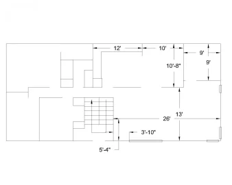

Floor Plan:
[Hearth.com] New to wood burning all over again
The main floor has an open floor plan with a living room, den, eating area, and kitchen all interconnected. We are hoping to put a stove or fireplace in the main living room and be able to heat the living area and keep the bedrooms warm. If possible getting some heat downstairs would be good as well. We understand that mostly we will have heat in only the main area of the house but that is why we have down comforters for the bedrooms. We would set the furnace to a lower setting or might even look at installing a thermostat downstairs if needed for more warmth down there.
We are looking at three options to place the stove or fireplace and they are:

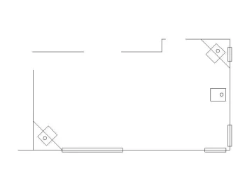

What we are looking for is recommendations on how to go about implementing a stove I will update this very soon with the floor plan and my ideas. But for now could you recommend type, and size. As well this will be on a low budget and I would like to do most of the install myself.

I'm not an expert, but I will answer just to share what I feel I have learned from reading these forums. I would go with the middle of the wall on the right side option that you have. I think that would warm the main room the nicest and allow the most air circulation. I would also want to stay away from blocking windows with my stove.
A solid wall would also give you the best options for pipe installation. Either straight up, or out through the wall.
Having the stove in the upper part of the room also gives you the best chance of circulating air down your hallway. As everyone here will tell you, you have to have fans blowing cool air down that hallway towards the stove to best get the heat moving.

From what I can see, it looks like you have a raised ranch. congrats on the purchase on your new 'to you' home. I agree with chaz, looking for a pipe run will be one of the considerations. With that said I'd probably avoid the stove being in the front of the house, unless you consider a fireplace, you may be able to find some easy to the eye options for a stack in front. However, I can't say I have seen many with that home style. I'm thinking your best bets will be on the inside wall of the living room or the right side wall of the living room, both areas may be better for flue chases. The center wall of the living room may be better to centralize the heat source and have a good run for the flue through the attic and a small amount showing out of the roof. The right side may be good for outside flue runs, but the pipe is not so appealing to the eye for some, it's all up to you. Good luck

I would put the stove on either the l/h wall that backs up to the stairs, or the wall opposite (where you have a stove placed). Those will allow the flue to go through the roof closer to the peak of the house, and keep more of the flue in the house envelope.
Stove choice.......are there aesthetic concerns or are you not limited in that way? For that sized house, a 2 cu. ft. stove or larger should do well. Many to choose from. Do you want long burn times or ambiance fires. How will you use the stove?
You'll need (probably) to place a fan in the hallway at the far left facing toward the stove room to get good circulation. Try it w/o first.

Just remember that the more centrally located the stove is the better it will heat the home. Also give consideration to bringing in the fuel and taking out the ashes. I fondly recall one home where they placed the stove in the room that had white carpeting. That did not go over well.

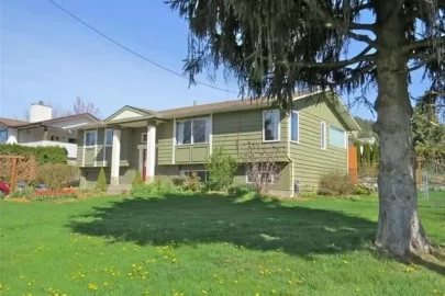

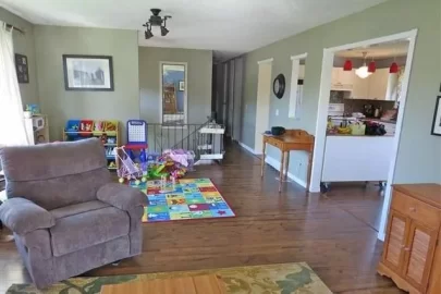

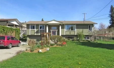

OK So there had been a comment about a funny looking chimney on the front of the house if the front corner was picked. Here are some photos of the house what do you guys think about the front chimney option?
[Hearth.com] New to wood burning all over again [Hearth.com] New to wood burning all over again [Hearth.com] New to wood burning all over again
Only way I'd put a chimney on the front of that or any house, is if it was masonry. Class A on the front of the house is just too redneck.
You are going to want to have enough chimney on the stove for it to draft well. Given that this is going to be a one story chimney I would try to avoid any elbows. Go straight up through the roof for the best draft. Even then, by the looks of things you will probably end up at only 14 ft or so.
Nice looking home. I have a similar setup. For an install on the main floor it looks to me that the end wall is the ideal location. I have a prefab fireplace there that is an older model. I consider it something. Nice to look at. Otherwise useless. We would like that replaced but it cost a lot.
For years, I heated with a wood stove located in the lower level. Now I heat with a pellet stove also located on the lower level. Yes, my bedrooms are cool, but the living space is comfortable. We have a furnace that kicks in when the outside temperature drops below 15::F. The floor space up and down is about 2200 sq. ft. Insulated except for the floor. The open concept of your set up encourages air flow.
Ask around and consider getting some professional opinions from installers in your area. They have a wealth of knowledge from experience and dealing with local codes. Also consider contacting your insurance company to see what impact this might have on your policy.
jtjf - if the door situation / arrangement were just a bit different, the spot between your kitchen and living area (where your telephone desk sits?) I might almost be tempted to suggest that spot (for a small stove with good tight clearances). Then again, small kids tearing across there may make that a bad idea to start. And I wouldn't be knocking out / changing anything existing to make that happen. Having said that, if it were me, I'd avoid the corner installs (especially in front of a window), and probably go with the right-hand wall location. Seems like this would keep your straight up run closer to the peak, which means more of the chimney inside the attic. Which could make your life a tiny bit easier from a temperature (draft) and maybe even a chimney stability point of view (e.g. you may not need extra bracing up top if you can come out near the peak?) Front wall install also means a bit less curb appeal, IMHO, would not look great....

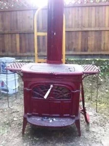

So for a stove in the temporary (next couple of years to save $) we are looking at picking up a intrepid 2 that is used it seems to be in good shape and comes with a matching chimney. I know it is undersized for our application but we feel we are really only looking to heat the living and eating area for now and use the furnace for the rest of the house. Then when my wife (see the positive thinking) lets me do this seriously I can invest some proper money in a real stove. Now what is the down side to the intrepid it is a model 1308. Can I run it on a ember arrester or do I need a hearth with r values? I would like to keep it simple for now so I can design for later on and not worry about having a wrong sized hearth for the new stove with different clearances?
So a no go on the vc stove. So I guess I can start looking at narrowing down what we want to use. So need to heat 1300sqft through the night would be nice and a north south would be good as well. What kind of recommendations do you all have?
