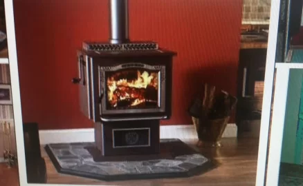

Oh ok i got it i was going to put down one of those pads you can buy then as the winter goes i was going to do a nice brick job on the walls it will be in a corner then after winter or before just dont know at the moment i was going to build like a step up to it mabe 4 inches up or so. Will that pad be good for now it has like a layer of some sort of material under neith it then its kinda like tile or stone on top. The first pic is the pad im talking about the second pic is what i want to end up with when im done.

Just remember that if you are bricking it up during the heating season you shouldn't burn for at lest two weeks as the mortar will crack. You don't want it to dry to quickly.

yea i thought it wouldnt be good to do it when i was burning at full pase. With just the right distance from the wall like the manual says should be ok for now right?
Pad will be fine. Have one under the NC30, house is still standing ( all of it) but note there is very little self support to one of those when setting a stove on top. So it needs to be well braced from below. And try not to drop a split on the tiles they will crack.

I've yet to find a single pad that meets the r-value requirements of the stove spelled out in the manual. If you have one, would you please share a link to it? Usually, it would take two pads for the type that I have found.

I discovered the same thing when I was considering the 13. It requires an R.2.0 rating and it seems like most 13 owners end up building something with Micore or cement board with enough rating.
So just a regular one won't work? I haven't seen them say anything about a value on the ones Iv seen. It's just tile and some sort of material underneath that.

Most standard ready-made hearth pads have minimal r rating. Unfortunately, the 13 has an unusually high requirement at 2.0. Take a look at this site. It looks like they make a raised hearth that meets this requirement. Scroll down to "Pedestals"

Well, like anything, it's what you want. Here is a commonly available stove board (hearth pad) for 50 bucks w/ an r-value of 1.5 http://www.tractorsupply.com/en/sto...ve-board-32-in-w-x-42-in-h-black?cm_vc=-10005
If the stove calls for more, and this is the only thing under the stove, the insurance company (or code inspector) will not be happy. Especially if there is a claim.
These are reliable products that work well, but if they don't meet the grade individually for this stove, I have yet to see something that says they cannot be doubled up to make things legit as per the stove's manual (so long as the dimensions as in length x width work as well)

Yea u see the ones they got for $399 that's cermic tile type two that's what I got but it don't say an r value?
Then you need to make some phone calls, look at any papers that came with them, etc. You need proof that you are in compliance with what the stove's manual requires.
