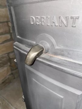

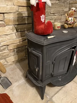

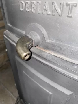

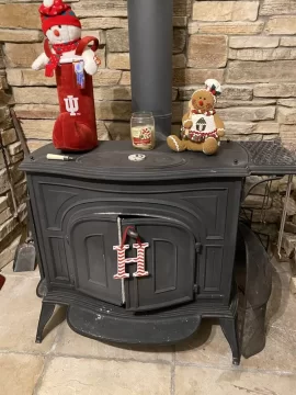

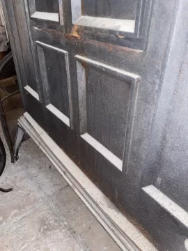

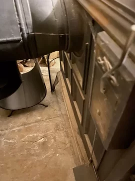

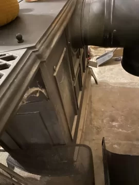

It's important to know what model Defiant this is. There are several. Is there a UL label on the rear of the stove that says the model number? If not, can you post a picture of the front and the back of the stove?
There is no label but here are some photos. Thank you for your help!

This is the original Defiant, from around 1979. I'll send you the manual. Note this manual covers all VC stoves of that Vintage.
Reactions: Evenhanded
The metal rod in the back is the “thermostat” handle, on the right is the damper. That stove needs to be burned hot to be clean, I had the vigilant stove which was just a little smaller but same principle. Decent stoves in their day, but keep an eye on the chimney every 3-4 wks. Burn seasoned wood!!!
