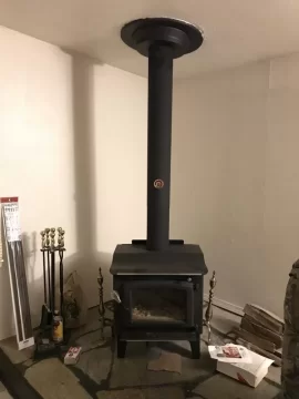

Ok well here is a picture of the overall unit, the brand on the door is Dutchwest. Also side note, is that a good place for the thermometer?

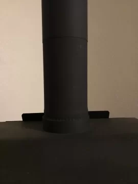

This is the slip joint about a foot or so above where the pipe enters the stove this is where I thought it was supposed to move but it didn’t

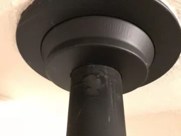

As you might be able to tell from the damage to the finish this is where the pipe is sliding up and down. Haven’t tried to see how far it will slide up because I assumed it shouldn't be sliding through here.
[Hearth.com] New to wood stoves, chimney question

I don't think you should be able to slide that pipe up and down that far. Can you remove anything at the ceiling and take another pic? Typically a smoke pipe adapter fits down through on the bottom side of the ceiling support and that adapter is positively affixed to chimney pipe on the topside.

It probably does not remove. Normally the smoke pipe adapter would be sticking through there and then the first piece of stovepipe would be attached to the adaptor. It looks like there is no adapter? It could very well be as you described and someone ran black pipe through? You really need to look above it.
I was thinking it was supposed to be as you described with the pipe attaching to something solid in the roof, which you are correct, it isn’t. I’ll get up on the roof here in a bit and report back what I find. Anything else that might help that I should get pictures of or take note of while I’m up there?

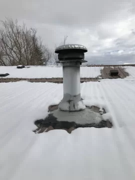

No attic just a normal roof. So I was not able to get up on the roof because of snow and ice but the chimney is close to the side of the roof so I got some decent pictures from my ladder.
This is an overall pic from a couple of angles.
[Hearth.com] New to wood stoves, chimney question [Hearth.com] New to wood stoves, chimney question

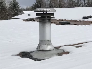

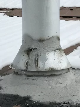

I disconnected the pipe from the stove again and had my wife slide the pipe up while I watched from up top. From this flared cover up the entire assembly slides up and down when she was moving it.
I had her slide it up far enough so that I could see the piping underneath the flare and it is not the black piping like in the house but silver. I’m wondering if maybe the black piping connects to a properly insulated chimney pipe above the beauty ring? Still assuming the entire this shouldn’t slide up and down though. Also the slip joint does move freely so that’s a good thing I guess.
So the whole thing is moving up and down? It could be properly attached but there should be a spot where the stove pipe attaches to the pipe adapter.
That pipe up top is galvanized? Selkirk metalbestos 1" insulation chimney possibly? Hopefully someone from down south steps in to help out. The Selkirk I'm familiar with is CF and would be as I described a smoke pipe adapter sticking down through that the stovepipe attached too.
I never see that pipe up here. Our manufactured chimney standards are different. Galvanized exterior chimney pipe hasn't been allowed on the exterior since the early 80's and shortly after that no galvanized at all.
It certainly could be some other type of chimney. Galvanized is rare to non-existent in my area.
The more I look at I think that it's a security cap not Selkirk.;em
Ok so upon further inspection inside, the black pipe does connect to a galvanized pipe literally just inside of that beauty ring. I was able to get the slip joint moving enough that the pipe was able to drop down to rest on that flared piece up top and stop anymore downward movement so I could actually get the slip joint opened up a bit more. With the flared piece in its “proper” location up top I am able to see where the black pipe is mated to the galvanized pipe through an 1/8th inch gap all the way around the beauty ring. So assuming the galvanized pipe is a proper chimney pipe, I just have to figure out a way to properly secure it to stop it moving upward. Assuming all of this is correct would that be a safe installation? And if so, what is a good means of securing the chimney pipe to stop upward movement?

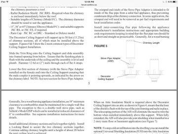

Is this a Selkirk SureTemp system? I've never installed this pipe but it appears that the chimney pipe just sits in the ceiling support. Is this right? I prefer that the chimney pipe twist locks onto the ceiling support to avoid this issue.
When weather permits I'd recaulk the storm collar top edge.
Reactions: Squisher
As best I can tell, yes it just rests on the other piece up top. I was able to get the slip joint open about 6 inches and get most of the of the stuff sitting on top of the baffle sucked out. Obviously can’t get on the roof to get the brush down and get the chimney clean but I won’t be running any fires until I can do that. As far as securing the chimney pipe, I was thinking of running self tappers around the perimeter of the flared part to hold it in place. Is that a good or bad idea? If bad what would be a proper method? You mentioned twist locking, how would I go about this? Thanks for all the info everybody.
