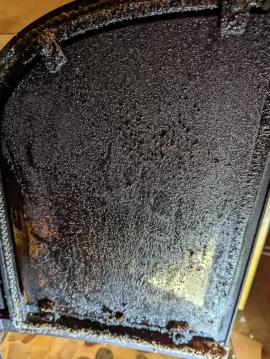

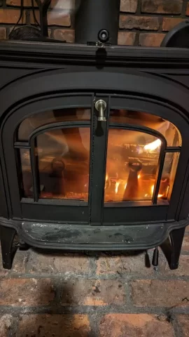

Do you get the black glass on the top like this? I can't prevent it. Happens every fire.
Yes every fresh start. It's impossible to avoid. But once you reload on a pile of coals and let that catch nicely and continue to operate it so they flames are always showing up, most of that will burn off. Having logs up a bit burning will cook that stuff off. That only happens if your bottom layer of wood is getting nice flames from a hot bed of coals and you let that bottom layer catch and then the second layer eventually. Very hard to achieve from what I can tell early into a load with the stove turned down. Once a load burns down do whatever you want as long as you see lots of glow or flames but early into the load try to keep that STT to at least 500 degrees.
In short , burn hot

Burning hot isn't helping. And one side gets more than the other. Looks terrible. If you open the doors and look on the right and left , there are air vents by the glass. The smoke starts where the air vent stops. I think that is the issue.
Ok let me rephrase. You need that entire box burning pretty hot, not just the stt. Once you've been burning for hours you can use that as a gauge but never during an initial load or when the damper is open. The Stt can be super hot yet the sides cool enough to touch.

Get a real solid bed of coals. Load the box halfway and burn it wide air for a few hours. It'll clean right up
Not how the stove was intended to be run, full time - BUT yes, this man is 100% accurate. In fact, this is how these stove operate the best.
Medium splits - 1/2 full to start on a great bed of coals. Learn to master that then work toward a full load. On a morning reload, Ive taken upwards of 1.5 hours with the damper open to get a load burning nice enough to close down to secondary and not risk the flames dying down too much and the glass turning black.
If you have too much draft though and really dry wood, you may be a bit toward the danger zone so keep that in mind.

I don't understand the stress over getting a little black soot on the glass. You're burning wood in a box, it gives off smoke.
Wellllllll for some it isn't just a little black spot.
And keep in mind most stoves don't suffer with a very poor flame watching experience. None that I've seen at least.
Otherwise, why put a damn window on it in the first place right?

I don't know how you accomplished that. I've burned mine cold damped down for 14 hour burns and only have soot not syrup like that. I've burned mine non-cat and damped it down to smolder and still only get soot. I don't have a stove merely for flame watching, I can open the air and it burns off the soot and I see the flames. The glass is a marketing tool and it sells stoves to people that want them in their living spaces that look pretty. The stove would be a better stove without the glass, probably make it cheaper and less places for air leaks but it wouldn't be as pretty.
My glass has never looked like that
