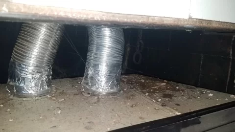

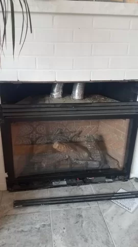

Is this a gas stove inserted into a masonry fireplace or a zero-clearance gas fireplace? Please post a picture of the fireplace so that we see what the dealer is seeing.

Here is a photo of the existing unit as well as the dims for the fireplace.
Height: 29"
Width (@opening): 33.75"
Width (@rear): 28"
Depth: 21"

Ok that absolutely is a traditional fireplace and should be suitable for an insert or stove. The fans that run on heat really won't do anything they are a novelty. But if you extend it out it should heat much better without a fan. But I would still install the fan for really cold periods
