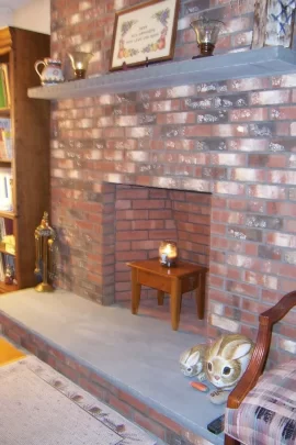

My brickwork is similar to yours. We installed a PA blue stone mantle and hearth. I will need a hearth extension, but will remove it when heating season is over. The Blue stone is 2 inches thick. We are looking at the Oslo as well and will go with the matte black - something I can polish. Sadly replacing our 33 year old Fisher. Fisher is going to be rehabed and used elsewhere.
