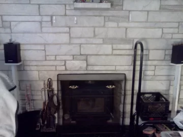

Hi there! I've been anonymously reading for a few weeks now in an effort to fully research buying the proper stove or insert for our home.
We have an old (1847) home and are looking at taking some heat (pun intended!) off of our yearly propane costs by installing a freestanding or insert stove. The house is 1,750 square feet located in central Virginia. It's also very poorly insulated in the original rooms. I've already spoken with a local chimney company who has explained the need to have a 6" liner installed.
Our fireplace measures as follows:
Opening - 39.5"w 34.5"h 17"d
Hearth extension - 24.5"
Cement surround - 6" on sides
Center line to mantel trim - 26"
From reading this thread I've gathered that freestanding stoves are more efficient for a variety of reasons, but I haven't had any luck determining whether or not our fireplace is suited for it.
Should we stick with an insert? I've also had a hard time find any faceplates that will fit our opening. Any guidance on brands, models, etc. would be a life saver! I've included a photo of our fireplace.

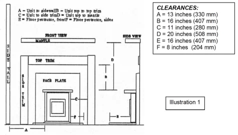

We don't have a mantel shield, but judging from the clearances I'm not certain we need one. Let me know if you think I'm wrong on that, please! Do you think a block off plate is something the chimney people would automatically put in or be able to do?

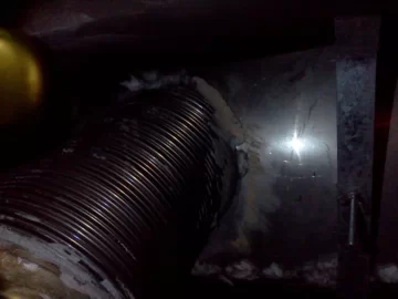

Many installers will avoid putting in a block-off plate. It's more work and will raise the cost of the installation. A typical short cut is to stuff insulation up around the liner in the damper area. Let them know that you want a proper, insulated, damper-sealing block off plate installed.
Here are the 13NCi's clearance requirements, click to enlarge.
[Hearth.com] New user, new to stoves, need serious guidance!
We don't have a mantle shield or have much to worry about in the way of clearances except for the front because the whole wall that the fireplace is on is constructed of white marble stones. These is no mantle per se, but several shelves that stick out from the stone wall but they are stone too. I will try to get some pics up here for reference. I would definitely insist on the block-off plate. I had 5 installers come for quotes (including a couple of total clowns) and only one guy wanted to insulate the liner and put in the block-off plate, actually he insisted on it. Of course, he was like $1000 more expensive but after reading up on here, I wanted this done right. Don't let them tell you that the top plate seals off the chimney and is good enough, that's nonsense. A ton of heat that would be warming your house will go up and warm the chimney instead.

One out of five is not that bad. I was sure it would be more like 1 in 100 who would offer by themselves to add a block-off plate. ;)
Insist on it. If necessary prepare it before the stove/insert is being installed using the instructions I linked to. Quite a few installers also like to stuff fiberglass in the damper opening. Either ask them for Roxul or go to Lowes and buy some yourself. Put it loosely in the damper area for added insulation before installing the block-off plate. If you need an independent installer search here: (broken link removed to http://www.ncsg.org/search) or http://www.csia.org/search

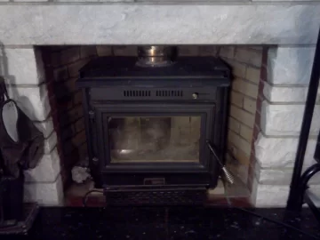

Here are some pics of how my insert looks...forgive the clutter, I'm in the process of painting the room.
That actually looks fine to me! Thanks for posting!
